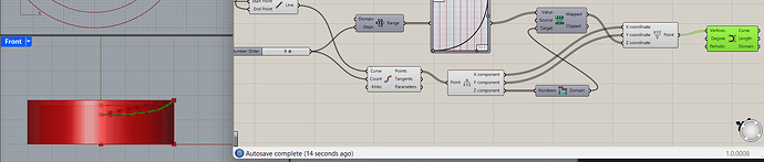

Yes, I am trying to do something like this
I believe this is a quick one, but I can’t figure it out, suppose I have a 45 degree curve from 0,0,0. And I want to control its curvature with a conic graph mapper, but keeping the start and end points. Like so:
[Curve]
This is basically right but it doesn’t seem like the mapping is fully correct:
at least, i don’t seem to have control over the ending tangency.
Here’s the internalized definition

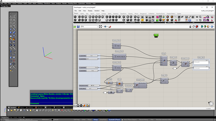

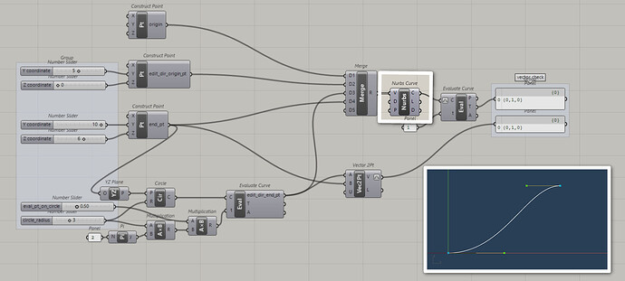

Since you want to have control over the ending tangent of the line, how about using the standard Nurbs Curve component?
By changing the position of the green edit points the curve and tangent can be controlled.
I put the edit point on a circle to easier illustrate the concept.
nurbs_curve_tangent.gh (14.9 KB)
Wessel
(Wessel)
April 15, 2024, 6:35pm
8
I did not use any plugins. But all component previews are turned off!

Hi @ct.rhino
Using @Wessel definition you can achieve what you want my moving the points that make the nurbs.
by the way @Wessel there is some plug in in there:
nurbs_curve_tangent_NL.gh (5.1 KB)
