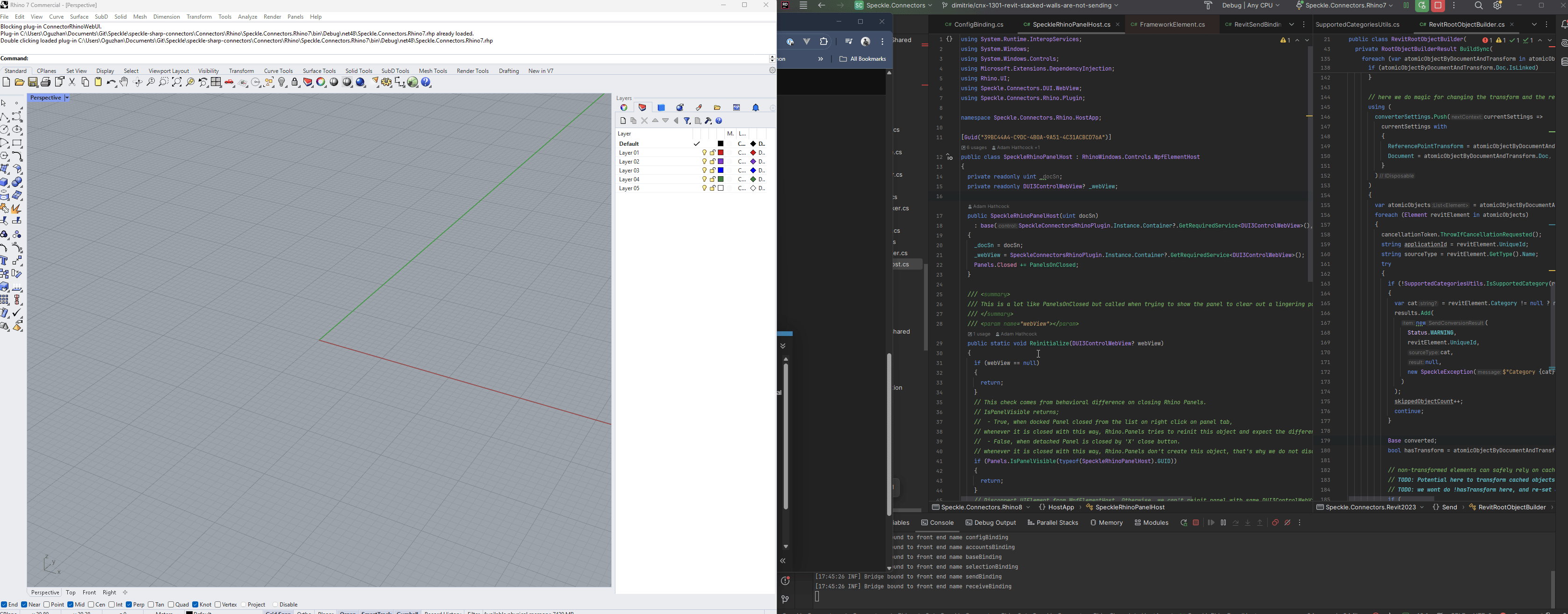

I think I need to provide more info
In Rhino 7: When I close the panel, it triggers the Panels.Closed event and I can succesfully unbind the logical component.
rider64_1Gu1cg2sav

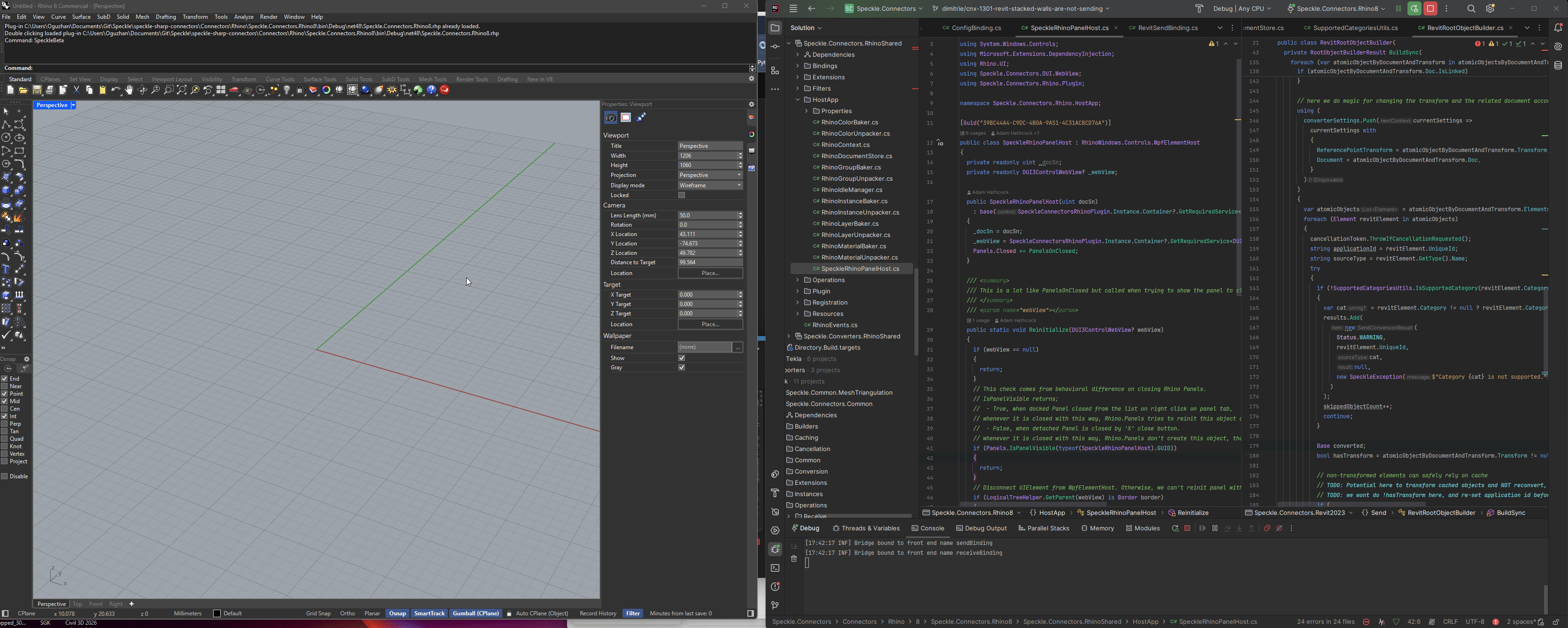

In Rhino 8: When I try to open already closed panel, having the below issue because cannot unbind the logical component
rider64_qJKuFCuLPE
I cloned your repo and had a look into it, the WpfElement doesn’t have some events I thought it would have.
I’ve created a ticket for us to look into this as it looks a lot like a regression to me.
