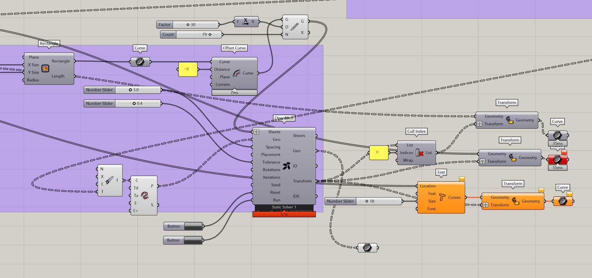

Hello, I am trying to use the Orient component for the purposes of digital fabrication. My issue is that when linking an XY plane to Orient, the “structural columns” portion of my script does not lay flat on the oriented planes. Flattening/grafting the geometry does not seem to work. Advice/troubleshooting would be highly appreciated. Thank you.

Where is this orient problem in your definition?
You also have a problem with the nesting component:
