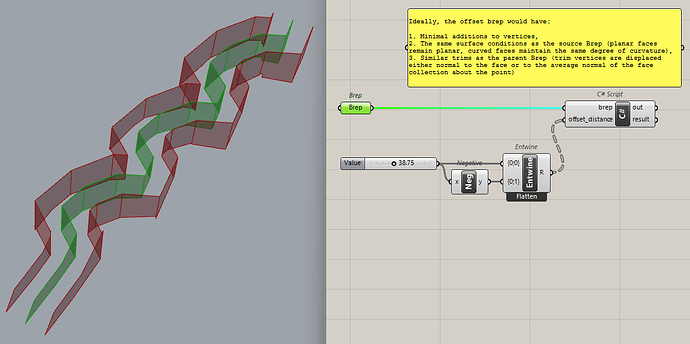

Hello everyone,
For a project I’m working on, I need to offset and modify a source Brep to populate with cladding geometry, but I can’t figure out how to create the offset correctly. The closest solution I have so far uses Brep.CreateOffsetBrep(), but it generates additional edges which ruin the offset for the purposes I need.
offset_example.gh (15.8 KB)
Ideally, the number of edges and the face conditions (planar faces remain planar, single curved surfaces remain single curved) would remain the same after the offset.
Is there a better way to generate the offset Brep? Any help would be appreciated!

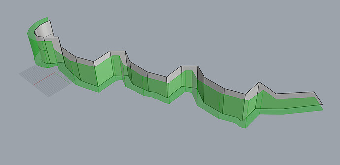

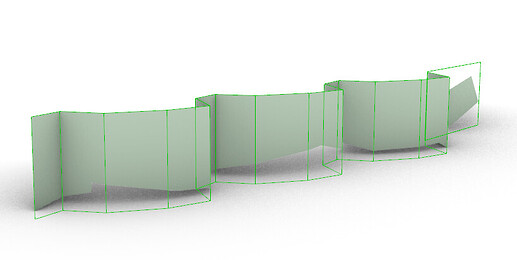

One quick idea that jumped was untrimming the faces of your brep to make a strip of quads and offset that to map the brep edges:
HOWEVER unfortunately your last (largest) face is naughty:
*And it still wouldn’t account for curved faces :melting_face:

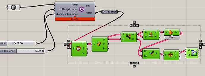

I’ve considered mapping the FaceTrims from the original faces to the offset untrim-faces before, might be worth looking into more. I have an idea that I’ll whip up here in a moment and see how it works, but it’s something like this:
  1. Generate offset like I’m currently doing it,
  2. Iterate through the vertices until it hits a vertex on an interior edge,
    2a. Check for nearby vertices; if they’re within some distance tolerance, add to a list,
    2b. Either remove these vertices or draw them to the vertex on the interior edge
  3. Output resultant brep.
I’ll keep you guys posted. Very much appreciate the help so far, feel a little less insane for having problems with this.

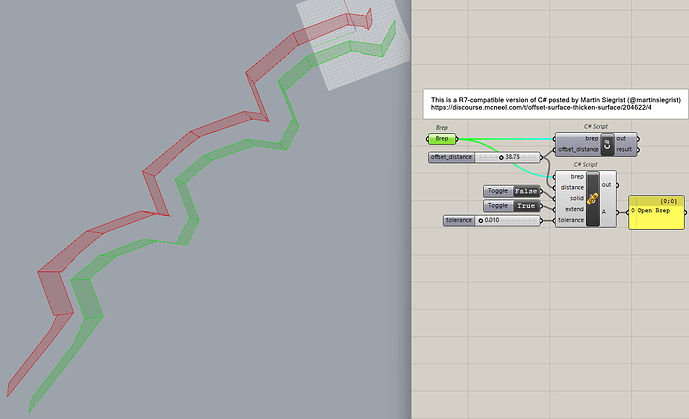

This recent post by @martinsiegrist is the first time I heard of it, though it’s been around for years:

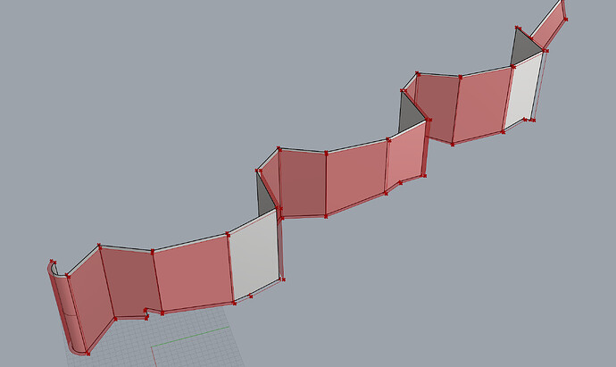

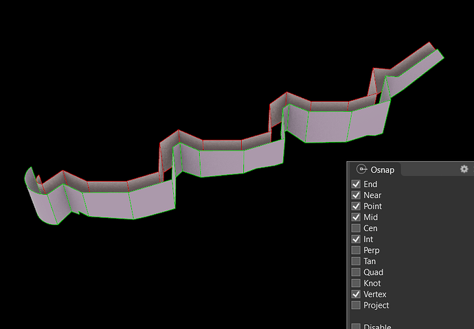

Okay, this kind of works, but it results in some naughty surfaces. So close!
offset_example.gh (27.4 KB)
I wonder what that is - if you bake them, they bake naughty, but if you bake the borders Rhino accepts the PlanarSrf command like nothing for the planar ones that are ‘invisible’. Changing the Rhino tolerance then recomputing GH left it with only one naughty one. Then increasing the tolerance by a lot made them all display properly.
But then returned tolerance to default and it seems ‘reprojecting’ them worked:
*Oops nevermind, zoomed in more and noticed disjoint areas
*Edit 2: decreased your ‘distance_tolerance’ slider and then they joined:
You have drastically reduced the offset distance, eh? Is that cheating?

This (below) is the first time I see what ‘extend’ does. You have it “hard coded” to True?
offset_brep_2025May29c.gh (19.6 KB)
Looks great to me, though some faces have anomalies.
My guess is that since I’m not deleting the vertices, only moving them to overlap a shared vertex, Rhino has no clue how to display them since they are below tolerance. Each face has a lot more vertices than it appears when looking at them in Grasshopper.
In truth, I need an offset of between 1 - 10 units (inches in my case), but the method does work for greater offsets. The tolerance might devour vertices you want to keep at a certain point though.
Will keep in mind - still new at posting. Martin and I are using the same RhinoCommon method under the hood. Extend in this case means that the hard edges are extended instead of being blended together.

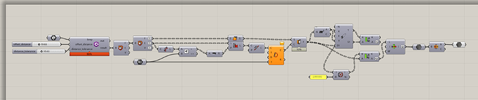

Okay, I think this is in a state that I can use now - thanks everyone for the help!
In case this is useful for anyone else, the way the method works is described earlier in this thread, but with the addition of culling the less useful edges. When using the distance tolerance, you’ll need to pick a value that is smaller than the smallest edge in your offset Brep, otherwise the method will collapse that edge as well. Very acute angular edges may also cause problems as the distance between the ideal vertex and the unnecessary vertices increases by sec(θ/2), where θ is the angle along the edge. Lastly, make sure to watch out for curved faces as their edges may collapse and ruin the surface condition near the edge.
Looking forward, some way of removing the duplicate vertices, calling BrepEdgeList.RemoveNakedMicroEdges() or even just reconstructing the Brep from the ground up using the new brep properties would go a long way to making this method better.
offset_example_2.gh (24.9 KB)
