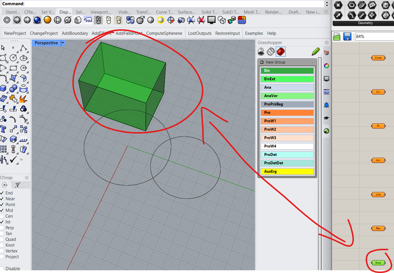

Hello everyone, I’m trying for example to set one circle in the Grasshopper Parameter circle component. By clicking on the Set one Circle Dialog Box it invokes Center of Circle command in rhino. That’s not the behavior I’m expecting. I was expecting an Arrow Icon to choose the circle but get a cross to set the middle of a circle in Rhino. I tried this with circle, curve, arc, line, point and rectangle all ending up with simular odd behavior. But not for Breps which is showing the behavior I’m expecting.

thanks for your quick reply. Tricky thing explaining just in words but now I added some pictures which are hopefully explaining the problem.
