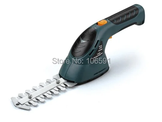

I think it would be a lot more helpful to explain how to model something rather than how to use a tool…For example how to layout surfaces? Most people probably make surfaces with edge to edge approach and its easy if you are modeling something like table lamp but how would you layout surfaces if you are asked to model something like this https://ae01.alicdn.com/kf/HTB1Zn84KFXXXXaiXXXXq6xXFXXXp/Brush-cutter-Handheld-mini-DC-Power-electric-battery-cordless-small-grass-cutting-machine-cutter-saw-dc.jpg
I suppose you could make a body as one piece with very complex geometry but surely there is a better approach
