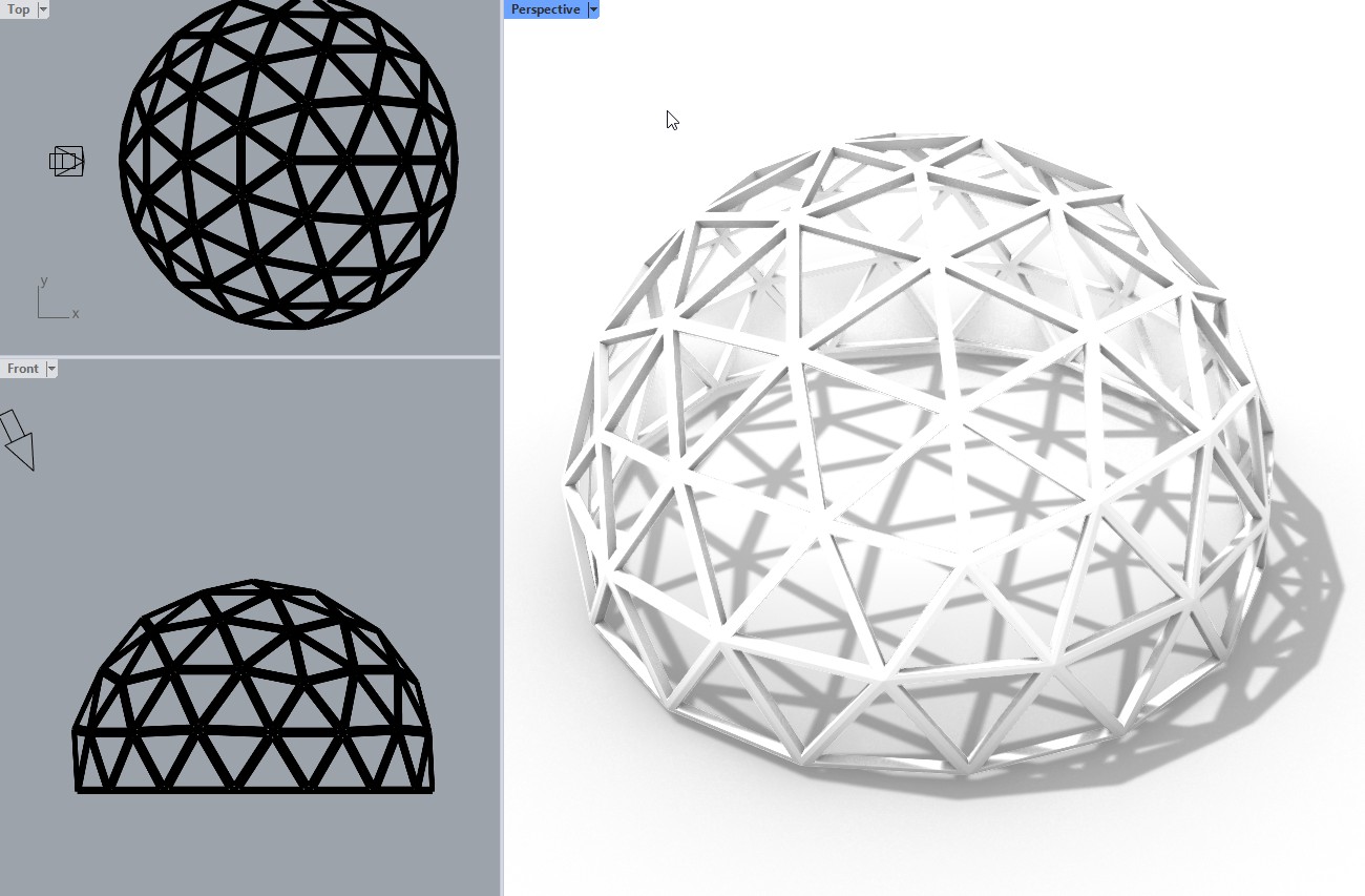

Can someone help me in achieving this kind of display view mode, help! i found it and its very cool.
Try adding a directional light in the default rendered display mode, and the effect is as follows.
Also, check out this thread: Share your custom viewport modes here
Perhaps the Rendered 4 and Rendered 5 display modes posted here may help you achieve similar looks. Note that if you play with the “Shadows” settings you can get a closer look at the cost of a heavily reduced framerate. You can also hide the isocurves if you wish. Both display modes are primarily made for modeling, hence the isocurves are visible, and the shadow quality is optimized for fast framerate.
This it looks really more a rendering than a viewport preview.
The smoothness of the shadows aren’t achivable with just a opengl preview.
It also looks like there’s a ground floor reflection, another things Rhino won’t be able to do as rendered preview.
You can do this, and far more, with a Cycles (raytaced) viewstyle but you loose the interactivity.
Anyway, yes it’s a really cool look.

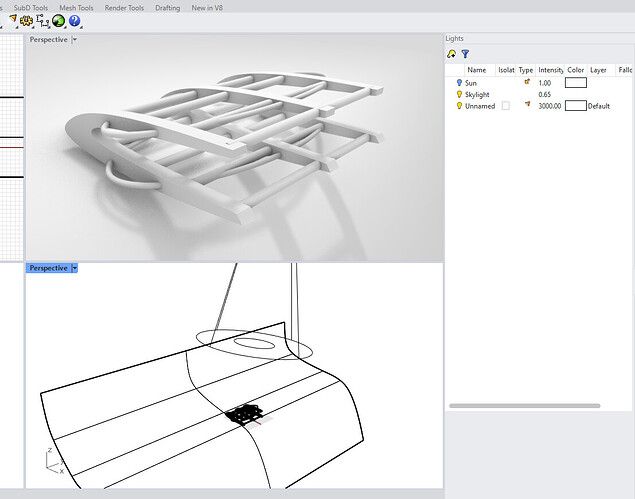

this appears to have a curved ground plane as well… you can do that in rhino by making you own backdrop stage and assigning the same material as your object
this is open gl rendered view with some lighting and material tweaking
