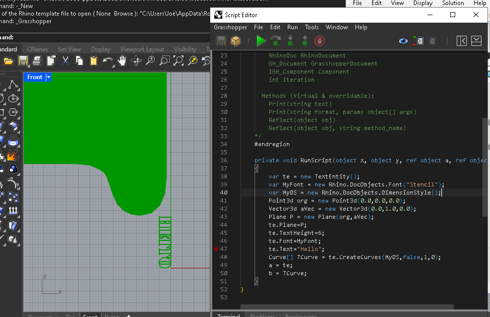

I want to make a Text Object as I would in Rhino and have the output as curves, But I want to do this programmatically in Grasshopper. The closest I’ve come so far is
TextTrouble.gh (6.5 KB)
Is there a good way to do text settings? The only way I’ve found is with the Annotation Style text settings and one problem there is that the size is affected by model space scale setting in Rhino. The other issue is that I can’t find a definition of Text Entity. I wanted to flow the text along a curve, but the flow component won’t accept the text as geometry so I grouped the text with a group component and it would not accept it unless I took the Text Entity output instead of the text. But it still didn’t work with the flow component. It seems this should not be so difficult. I’m working in Rhino8.
