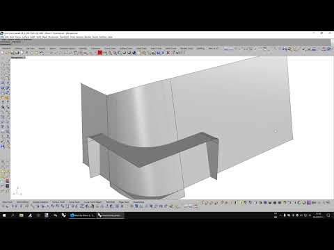

There is a new command in Rhino 7 called ! _RefitTrim which could be handy in situations where you want to convert a surface whose end have been trimmed into a similarly shaped surface that tries to mimic the former while being untrimmed. In order for this to work properly, only one edge of the surface must be trimmed at a time. But keep in mind that it will never be 100% same as the trimmed original and there may be some deviations here and there. But when it works, it’s priceless. :slight_smile:
Here is one of the bugs that happen with the “Refit trim” tool and hopefully it will be fixed soon:
