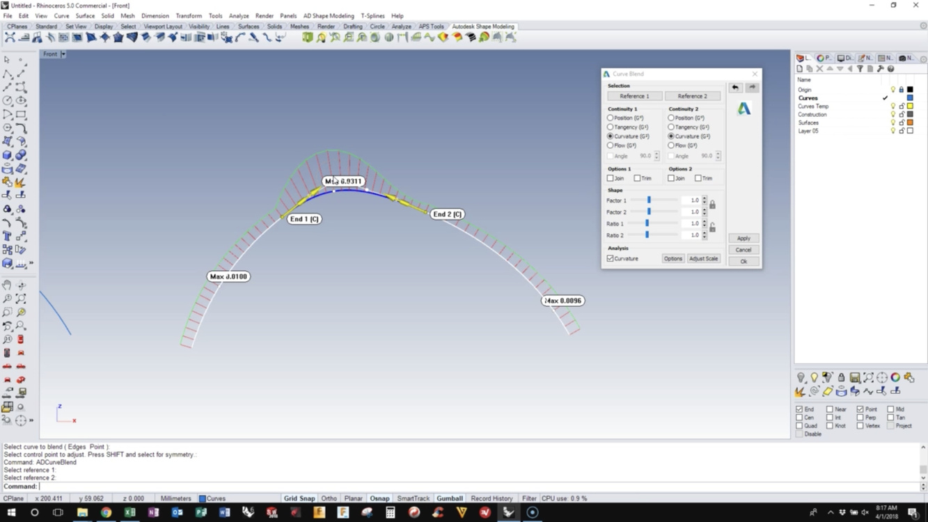

I also have VSR in V5, some nice tools but this isn’t a good example in my opinion. Compare these two screenshots from your video. In Rhino’s you can see the actual curve. In VSR you see a bunch of UI elements, labels, numbers that don’t matter, and gigantic yellow curves that occlude the actual curve. This is nuts in my opinion.
Hi Gustavo, thanks for pitching in.
