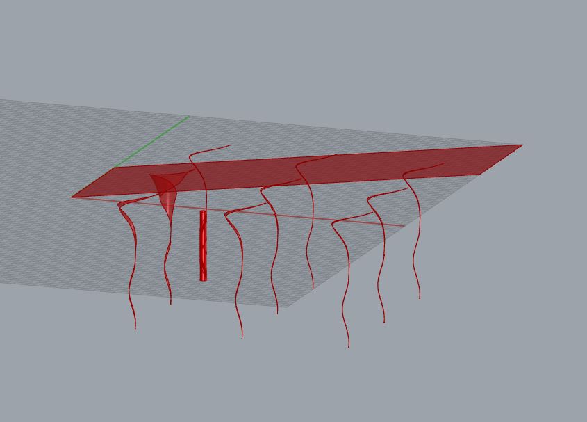

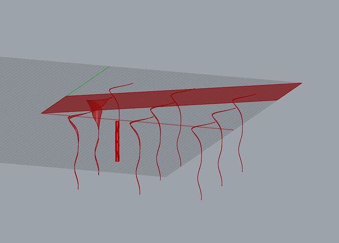

I am trying to create a pattern similar to that of the Nine Bridges Country Club structure, and morph it onto a surface resembling that structure, I have tried a few different approaches, but when it comes to morphing the pattern to fit the surface, the results always come out awkward and unexplainable, atleast to me. I am quite new to grasshopper, only working on it for the past 2 days, so any help or advice would be appreciated, on how to fix this issue. What am I doing wrong? Any way of making this work and making it more efficient?

Hi, thank you, I did actually try looking for them at the start, and did look into a couple, but I couldn’t find any that didn’t use external components, whereas I was trying to approach this problem with existing grasshopper components only.

Thank you, I’ll try this approach, do you have any potential tips on manipulating the curves from the pattern to fit the column shape? Is there something similar to Rhino’s FlowAlongSrf or do I have to take a different approach to creating this pattern net of curves, since from my understanding Surface Morph only works on objects with volume?

I scaled your columns and eliminated all but one because the grid seemed too tight.
I tried to play with idea a bit. it is very similar to what is done here.
Make the lines
Cut the lines with circles
Deform the curves with a graph mapper
Find the curves that are cutted and blend with the column. In order to blend correctly I use a rotation angle to have the best result.
This method allows not to be limited to 12 beam on each column, here 24
here 12 beams
