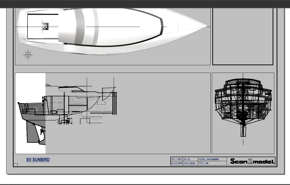

Hi All,
I am trying to draw up some boat plans for a mate of mine.
I have already created a 3D Rhino model from Laser Scan data and am now just detailing a refit of the interior.
I am using a slice plane in the Front View etc to create views.
The boat model, with a clipping plane down the centerline looks like this when shown in “Monochrome” .
This if from a standard windows screengrab.
If I use “View, Capture, To File” the result is this.
If I create a layout page, it looks like this
If I change “Monochrome” to “Pen” in the layout, it does this.
And yet the printed pdf looks like this
I just tried using the Section Tools and I get similar results,
What am I doing wrong ?
Thanks,
Mike.
Sysinfo looks like this…

I just tried opening the same file on my laptop…
This time I get the result that I was expecting, so I assume it is a graphics problem on my Desktop.
