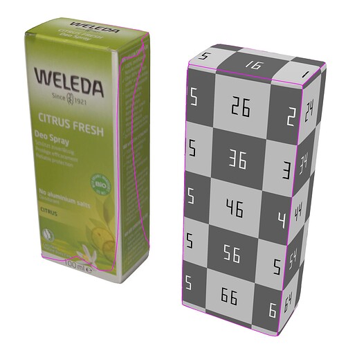

Ok, so I have a test file with a scan of a small cardboard box. Unfortunately I do not understand the logic of the command just yet. I’ve tried a few things but couldn’t get the texture to adapt to the new mapping.
The Rhino 8 file below contains two meshes. The scan with its original seams and a copy which I welded and split at the creases. I unwrapped the copied mesh and was able to align the parts in the UV editor.
I selected the original mesh and added a second mapping channel using the copied mesh.
I’m not sure what the Fill pixels around option means.
I’ve managed to get a resulting texture file that showed all zix sides of the box once but don’t understand what I’m doing wrong.
This is how the texture file looks like. Something isn’t working:
I’d really appreciate if you could take a look at my file:

Hi @martinsiegrist,
You were really close, the issue was the custom mapping object not being directly over the source when that custom channel was created. I made a video covering the details here… BakeMapping in the Rhino 8 WIP - YouTube
