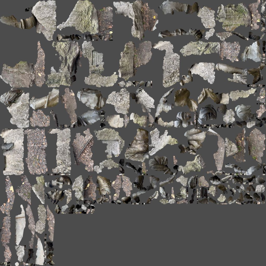

To get this right on 3D scanned models would need to map the previous polygons that the new polygons of the reduced mesh lies above and then re render a new texture, one polygon at the time. It would be quite the undertaking, but should be possible with some clever thinking.
3D scanned models tend to have complex textures with bits and pieces all over the place, so figuring out a good unwrap process of the new mesh would be the first step to take.
Here’s an image of a model I scanned today with scaniverse on iphone 13pro (requires lidar)
And it’s texture:
(Resized from 8192x8192px to 1024 for size here on discourse)
