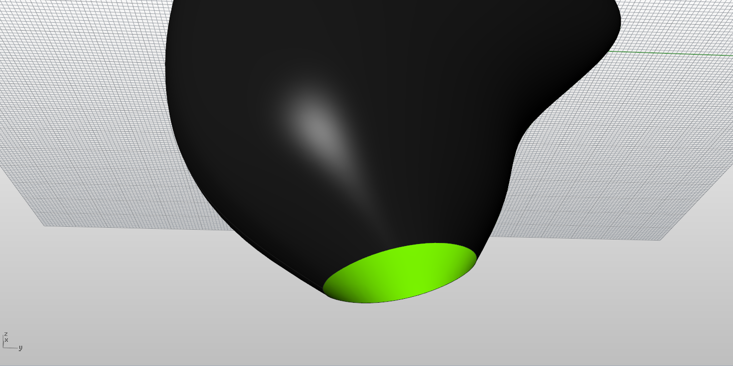

Hi, guys, I hope I can revive this topic once again. Could you help me with this one? I tried Network surface but I feel that this surface might need some work first. I always have problems with non-uniform(or what I’m trying to say not round or oval) shaped tips that need to be capped.
Handle.3dm (1.2 MB)
I hope patching can be avoided, and something smooth and nice could be achievable.

Hi Tim - I’d still use a loft here, just set up a little differently -
  1. Set a Cplane to the planar opening
  2. DupEdge the edge there
  3. Mark the AreaCentroid of the edge curve
  4. Scale2d copies of the curve inward.
  5. Move the middle curve and the point together off the plane - vertically that is.
  6. Move the second curve up, but less/
  7. Using History, Loft to the point, using the Loose loft style.
  8. Always keeping the point and the middle curve in plane with each other, use Gumball to move and scale the input curves until it looks nice, and has reasonable continuity with the main shape
  9. MatchSrf for Curvature to clean up - make sure Preserve other end is set to Tangency. (Breaks history so get it close first)
HANDLE_PG_11-4-16.3dm (1.3 MB)
@jim Hi jim, thank you for reply, I tried to replicate the result. You blended original surface first, then trimmed out the ugly generated top to cap it… here I’m a bit confused. Blue curves try to match the curvature as close as possible but not precisely, right?
@pascal, gotcha. Faith in loft restored XD. Here is a third try, I guess the “feel” comes with practice. I assume your example wasn’t the result of a magical first try )) Gonna keep trying, thanks for this awesome technique.
Hi Tim - make sure to adjust the mesh in Zebra - set Minimum initial grid quads to say, 5000. Or more in this case. Setting max edge length might be good in this case as well since one surface is so much larger than the other.
Ok, I will note that. I cranked the slider all the way to the right on simple controls, I think it was just a poor loft that time. I’ll keep trying. Thank you, @pascal.
Slightly better, it takes a lot of time and “feeling” to make it right.
