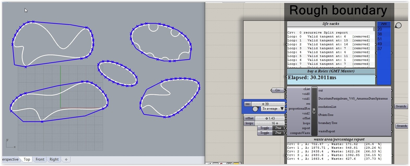

Well … not sure at all if this is usefull for the occasion but anyway: I did something “similar” long time ago but yields a convex min envelope polyline because the machine in question was able to work only that way. Is recursive: given a resolution value (defined with 4 ways against a curve List) divides a given Curve in the List and then offsets the points (outwards) and validates the tangents (as LineCurves) as candidates for the recursion (i.e. a tangent is valid if yields null ccx events against the curve).
The start boundary Polyline is the base of the Box (or BoundingBox) per Curve.
For each recursive loop each tangent splits the previous Polyline boundary in 2: the inner (the one that contains the curve: this is a candidate boundary) and the outer (his area is always measured). The boundary picked for the next loop is the one assosiated with the max outer area (kinda a sync Array Sort using areas and boundaries). The core Method for all that:
Each success (where the previous boundary becomes the boundary picked) yields a removal of the tangent used. Each tangent that yields an invalid (for any reason: tol, small area, Method failure, Karma etc) inner/outer pair is also removed.
If you run out of tangents or no valid pair is found or you reached the max loops the recursion stops.
