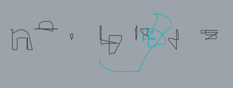

Recently noticed you can import SVG in V6 now - great addition!
The first attempts failed though - the curves come in messy and scattered on first 2 files I tried.
(compared to Illustrator import where all looks fine). Problematic files attached.
