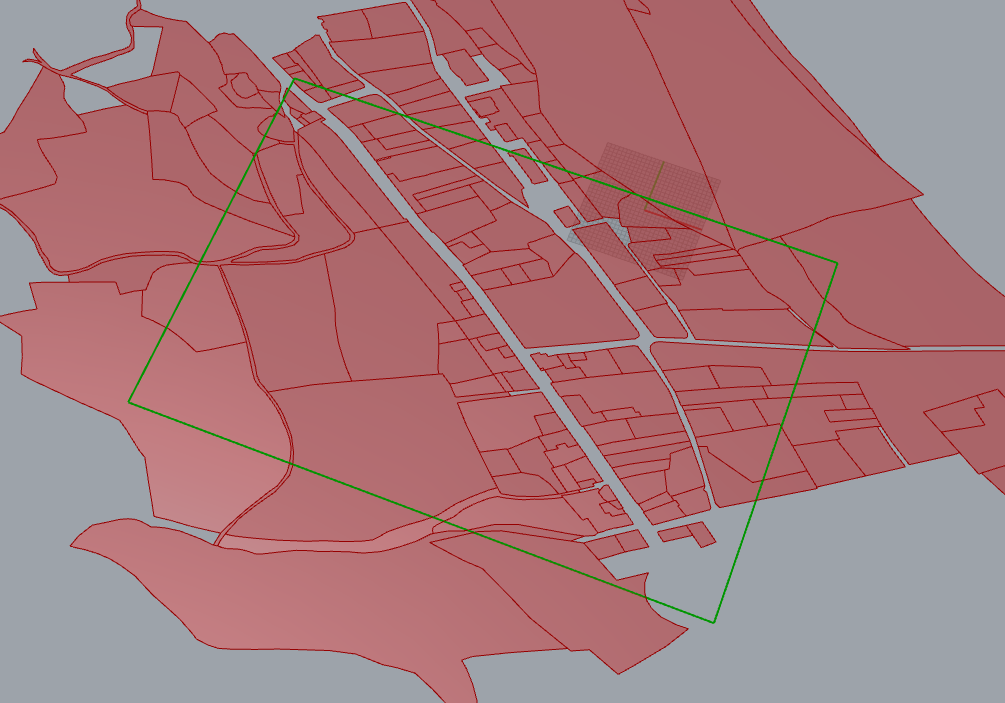

I am trying to obtain the intersection between these planar meshes:
However, I don’t find the way.
MeshIntersection.gh (172.3 KB)
Note: obtaining the mesh edges, then intersecting the regions and remeshing them is not a valid procedure for me.

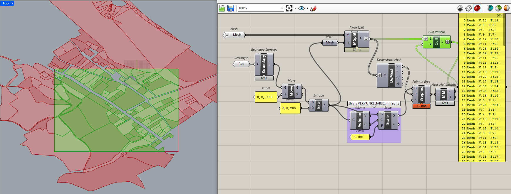

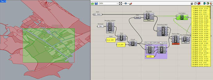

LoL because I had to force point inclusion testing by scaling the splitting box because the split mesh centroid was still inside it
the one shown here is a very stupid and unreliable way of culling the trimmed patches… I didn’t figure out anything better at the moment, someone will for sure post a much smarter filtering soon
MeshIntersection_inno.gh (187.9 KB)

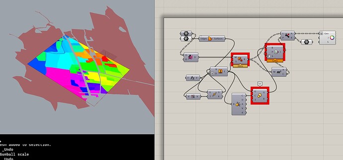

Would be interessting to know, what circumstances lead to the use of Names / Icons on the components ![]()
