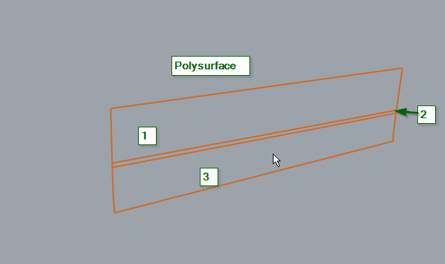

Merging polysurface into a single NURBS surface
Scenario:
Calculating the gauge dimensions of curved surfaces/polysurfaces.
What I did:
What I need:
  • Guidance / approach / algorithm / code snippet - how to convert this mesh back into a single nurbs surface.
  • Publication / Scientific article explaining a method to do that

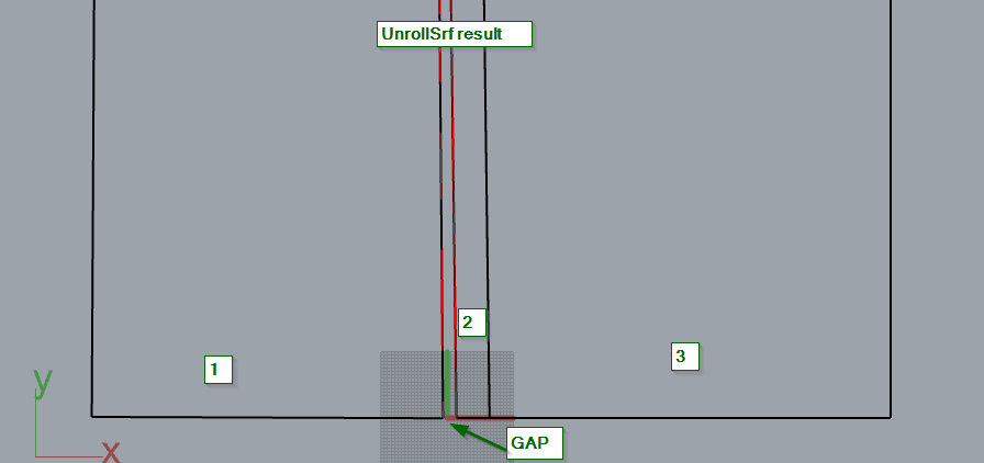

just set the second argument to false and go from there.
Doesn’t work every time, sometimes the resulting flattened polysurface is connected through a point and there’s a gap. This is wrong.
Probably because the surfaces are not exactly developable. UnrollSrf is intended for unrolling developable surfaces. If a surface is not exactly developable it is not mathematically possible to flatten the surface without distortion.
Have you tried using Patch to convert the mesh into a surface. You may need to experiment with the number of U and V spans to obtain the desired accuracy.
This is a bad command, I mentioned this in previous threads
True but you’re trying to do the mathematically impossible, so you’re down to using “bad” tools if you insist on trying.
All I need is to have the gauge dimensions and area within accepted tolerance.
That is not mathematically impossible
Interesting. I use Patch frequently to obtain surfaces from a relatively dense set of points / mesh and obtain good results. . The density of input points / mesh may need adjusting. The maximum edge length option is one method to increase the density of a mesh. As I mentioned above some experimentation with the number of U and V spans used in Patch may be needed to achieve the desired accuracy without a sufficiently smooth surface. Patch produces a single degree 3 surface without creases. If the input represents a surface with creases etc. then a single application of Patch will probably not produce the desired result.
If the input does not have creases then Patch should be able to produce a single surface which will Smash or Squish with sufficient accuracy. Of course if the surface is non-developable the flattened surface will not be unique. Different assumptions/settings for flattening process will result in different results.
