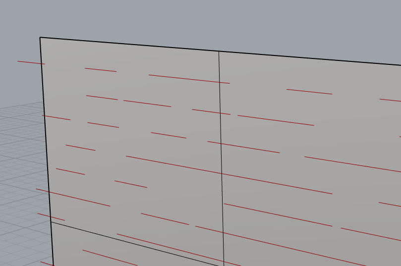

I’m trying to create a facade with horizontal wood beams and I’m struggling with some overlapped curves.
The idea is to create a point grid > reduce > create my lines > extrude with the surface normal vector > extrude to create the height. (see the attached file)
But, my results always give me overlapping curves. That’s ok, was expected, but I couldn’t manage to merge then into one single curve.
The image below is from Grasshopper, looks exactly as I wanted.
But, after baking, we got overlapped curves
I want to achieve this: one single curve.

There’s a component called Topologizer that can take care of those overlaps for you.
Inno! Thank you so much!
The awnser was under my nose. Actually worked and solves my problem.
There’s some shorter chunks that I manage to delete with cull pattern.
