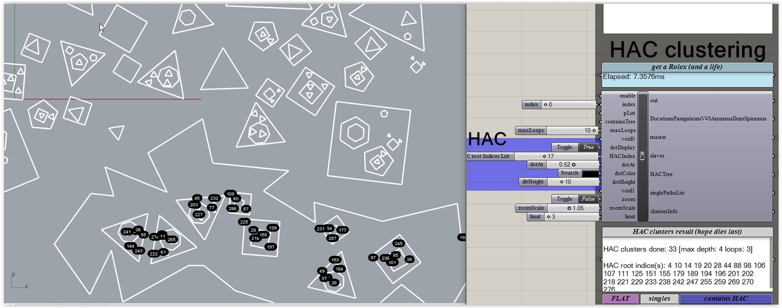

Hi everyone,
I was wondering if anyone could help with this problem. I have a set of planar curves (all rectangles but I imagine the same process would work with any non concave shape) where most of them overlap with at least one other curve. Is there a process where you can input these curves and it will return the largest set of curves where non of them overlap.
I’ve made a basic attempt but I imagine the optimal way to do it will involve an iterative process.
MaxOverlappingCull.gh (23.9 KB)
Thanks in advance
That’s a classic Cluster Analysis puzzle (where Clustering criterion has to do with Curve/Curve ccx events OR containment OR some “similar” other within the given collection (List or Tree)).
If there’s nested criterion/containment situations you’ll need HAC Clustering (Google that). H stands for Hierarchical as opposed to Flat Clustering.
The result is a Tree where each branch contains the related (i.e. Clustered) Curves … thus if you are after “single” Curves … you sample all where a given branch has just one item - all that for Flat Clustering. Or you can query the Tree with any other way (like find all Clusters with N items or items > N and < M or items with K ccx events or whatever … etc etc).

BTW: Given the opportunity … with randomly suffled collections … here’s an indication upon what HAC means (and how to represent the nesting via indices as path dimensions that also explain what contains what - singles are items with no childs):
Or a more simple case:
Or a more complex one (on ~300 Polylines):
With regard the preparation of data compare 20 ms VS 600++ (if we use the Rhino Curve/Curve containment Method):

OK, that’s a very easy ccx Clusering case (and it could work “relatively” fast up to 1K curves (hope dies last)).
Moral: If no Python Samaritan on sight (within this day) … the salvation could be yours via C# (BUT using standard Rhino Methods and not the 20 ms thing shown above).

Half day past, no Python Samaritan on sight. Here’s a preview with 4 modes related with the next big thing:
LOL mode (for the brave) : get all shapes in contact, forget classic ccx :
Classic ccx (mind that shapes in contact do yield ccx events):
Classic ccx for the rest, shapes in contact sampled as singles (blue thing empty):
Classic ccx for the rest, cluster the singles (their indices registered in the blue thing):
That last mode requires a second pass … thus elapsed time grows (truth is that 18 ms is a big increase … but no pain no gain).
