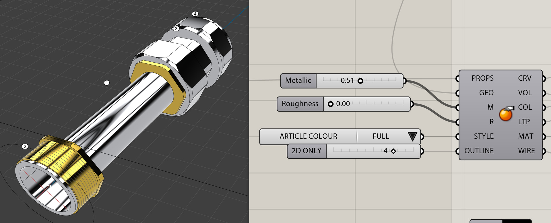

I have more questions regarding this:
This is what I am seeing when material props are passed directly to the output:
And this is what displays when materials are deconstructed and constructed from the same properties:
Shouldn’t it be the exact same appearance?

All I wanted to achieve is better control over material reflectivity to get more roughness in it.
And the final question for today: why the difference between rendered and any other view style?

This is complicated in that there are a lot of different material material types being used together. Being caught between two Material types can be quite confusing. Material types cannot easily be mixed and matched.
I you want to drop the example files in this thread we can work together on them to get them untangled.
The menu image below is the OpenGL materials, quite simple and what has always been in Grasshopper. The menus is quite simple because the material is not that sophisticated. The icon is the Golden Egg. Technically they are a Grasshopper thing only. So, in the examples above, some non-render displays still show materials because Grasshopper is displaying that, not Rhino:
The next menu is the newer Rhino materials that are quite sophisticated. The icon is a paint tube. These were added some in V8 and more in the WIP. These have a lot more control of roughness etc…
Based on the material style used, use the same components that belong to each material style. OpenGL (Display Material) for quick previews. Or use Rhino (Model Material) materials for actual control of a rendered material:
Then on top of this there is how materials are displayed. There are 3 modes.
  1. Rendered mode is a quick rendering step that will display most effects but will take reflective shortcuts to speed up display. Best to use Model Material here.
  2. Raytrace mode is a slower display but will use more of the reflective effects and is the best results that can be used. Requires Model Material for any control
  3. The OpenGL (Display Material) Is Grasshopper overwriting the Rhino display no matter what display mode is being used. This is the quickest and simplest way to work, but does not give much control.

When it comes to Metallic, there are only two values
Anything below 0.5 (included)
Anything above 0.5
Other values do nothing for appearance.
Roughness offers slightly bigger spectrum of values, but the change can be noticed only at >0.6
