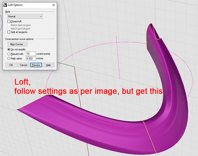

tried for _Loft, select the three profiles, as I only had three anyway, place your settings in the box, and get this.
what went wrong ?
lumpy sweep1 now 3profile sweep1 creases loft fail.3dm (653.3 KB)

The “Loft” tool tries to interpolate the shape along the input profile curves. Think of it as an elastic rod that you bend along hard points. Since you use just 3 profile curves, the interpolation of the shape is accelerated mostly at the middle one, whereas each tip is almost straight. If you use 5 profile curves instead of 3, that will give more definition for the “Loft” tool to create the desired shape.

Circles are ok. Just make them degree 5, as you would with their best friends, the arcs and the cylinders ; )
