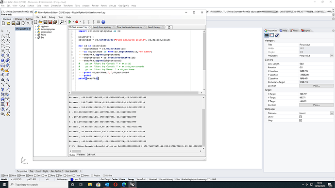

I am still getting slightly confused I can get the following output from my script
objectIds = rs.GetObjects(“Pick measured points”, rs.filter.point)
#for id in objectIds: print “Object identifier:”, id
objectname = rs.ObjectName(id)
if objectname == “None”:objectname== “No Name”
objectcoord = rs.PointCoordinates(id)
print objectname,",",objectcoord
3 , -170.746075173116,200.24702273105,-23.3611932323999

Which are the name, x y and z of the co ordinated points in my workspace. I want to be able to make a list that I can then sort all the data on either the name or x or y or z values ascending or descending. Un fortunately the more I read about lists the more I get confused as I want the data to be shown as above as rows not one long list that is hard to read.
So I need help with creating a list, sorting a list and displaying a list in the sorted manner the Rhino function side of things is ok, I think.

Now I get my list measPts how do I sort that on name, x,y, or z ? Can I show the list in a better way not one long string ?
It’s quite hard shifting from VB script to this as the mind set needs to change, but I will persevere.

Just to add a few more examples of sorting points by some property using sorted():
These are implemented in GHPython, but should work the same in the EditPythonScript editor.
You can also use the list.sort() method to sort an existing list without creating a new one
from pprint import pprint
points = rs.GetObjects()
# sort by object name
points.sort(key=rs.ObjectName)
pprint(map(rs.ObjectName, points))
# sort by X then Y then Z
points.sort(key=rs.PointCoordinates)
pprint(map(rs.PointCoordinates,points))
# sort by Z
points.sort(key=lambda x: rs.PointCoordinates(x)[2])
