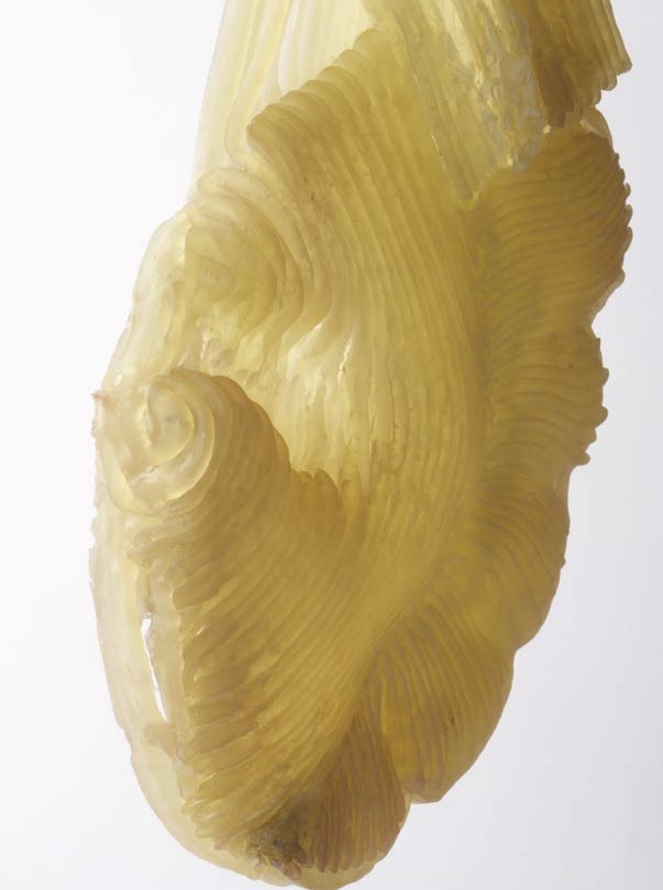

In 2017, MIT‘s Self-Assembly Lab published „Large-Scale Rapid Liquid Printig“, outlining a new manufacturing method for liquid, curable materials. Depositing the liquid into a thick, clear gel, the material stays in place and cures, either over time of through ultra violet light. This is an entirely new manufacturing method for many industrial grade materials, that previously relied on Injection moulding.

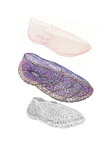

Because liquid printing works radicaly different from other manufacting methods, it also opens a space for new design strategies. As part of this project, a workflow was implemented that translates intuitive drawing in 3D space to movements of the printing nozzle within the gel. This creates a blurry boundary between the physical and the file, where real movements create real objects through a digital bridge formed from Virtual Reality and industrial robotics.

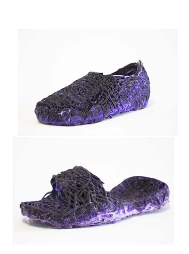

Follow my exploration through the stages of setting up the technology, test printing, developing an unprecedented design strategy and executing it through wearable prototypes.

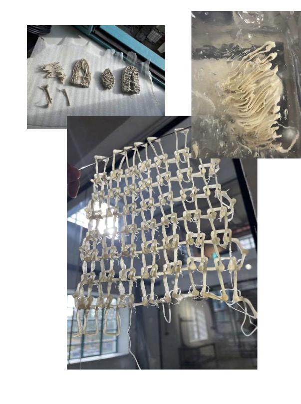

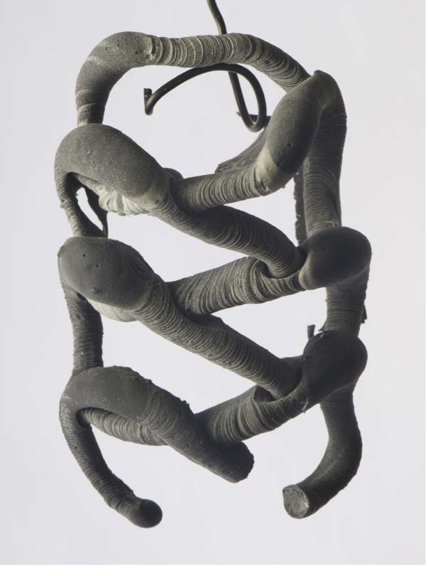

Some test prints for different Liquid printed structures: polyurethane printed into a carrying hydrogel.
