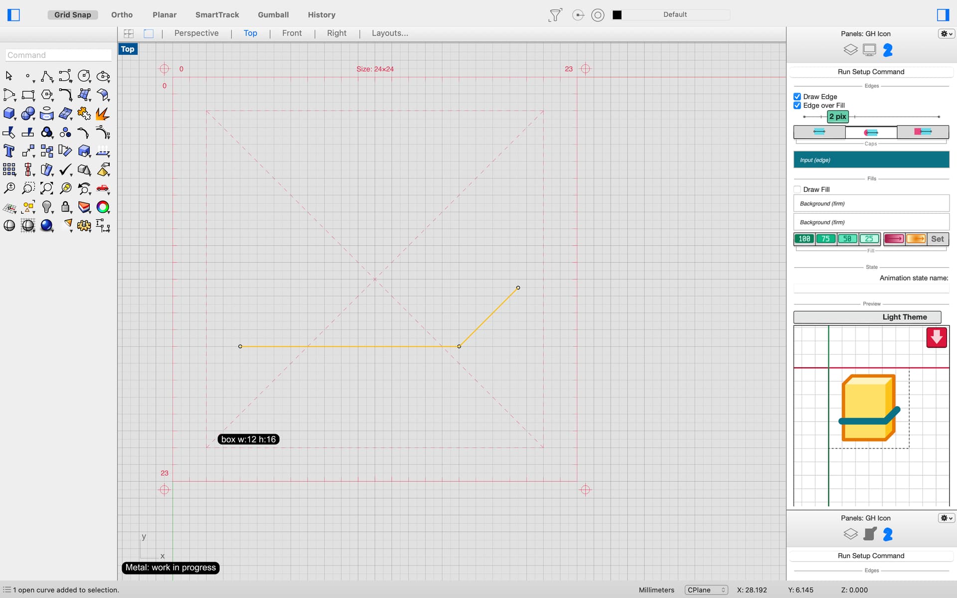

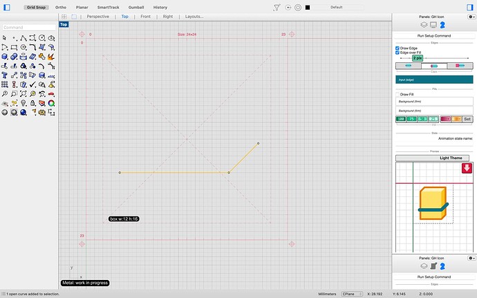

@andheum since I apparently can’t stop you from making plugins, I can at least tell you how to make icons for them. There’s a Rhino panel called GH Icon. It allows you to draw icon shapes in Rhino and export them as *.ghicon files. Embed the ghicon file as a resource in your project and if it’s named the same as your component class, it’ll automatically load. If it’s named different, then you can load it using one of the static Grasshopper.UI.Icon.AbstractIcon.FromXXXXX() methods.

How do you do the exporting? the red “arrow” button over the icon in the GH Icon panel doesn’t seem to do anything for me — but maybe I’m looking in the wrong place.
