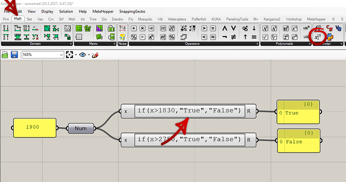

I am trying to write an expression that will tell me if a number x is larger than two other numbers. For example:
I want to know if x > 1830 and if x is >2750 at the same time. And have a True or False return.
Does anybody know if this can be done and how?

or for components check Math → Operators, “Gate And”
2750 > 1830 so if x > 2750 than it is for sure > 1830
Thank you! I Think that the Gate And component did the trick.

you can use Evaluate component or Expression component
Tom_P
6
the operators already return true or false…

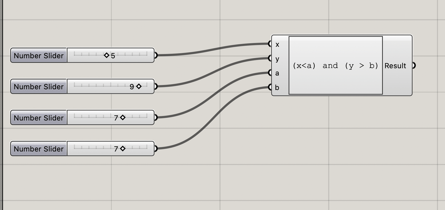

keep it simple and do all the logic in one expression:
zoom close enough to add more input / output connectors.
