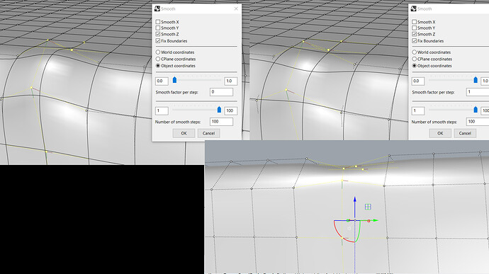

I already used some of them, however none of them can fix the bumpiness of the surface all the time, it depends on how the control points are at the initial configuration, and how is the conformation of the surface that you want to preserve. The main problem is that any type of smooth does not consider the curvature of the surface around the smothened area, but only the coordinates of adjacent vertices.

Actually the smoothing does use the curvsture, just not explicitly. The curvature at a point on a NURBS surface is directly related to the adjacent control points. Algorthms such as in the Rhino Smooth command do the most smoothing where the curvature is greatest.
True but it’s only a consequence of the coordinates of the points, it does not calculate the curvature and tries to match it, for example look at this example, once smoothened the points goes too down, if it would try to correct the curvature as in the edge flow plugin for blender the points should match the curvature
What curvature would smoothing try to match?
For the situation show you could use the smoothing function in MoveUVN.
Maybe this case is more clear, the edge flow command would match the U loops of vertices with the drawn curve, the smooth in the MoveUVN flatten them, because it average the inner vertices with the coordinates of the adjacent vertices it does not try to match the curvature of the surface around
