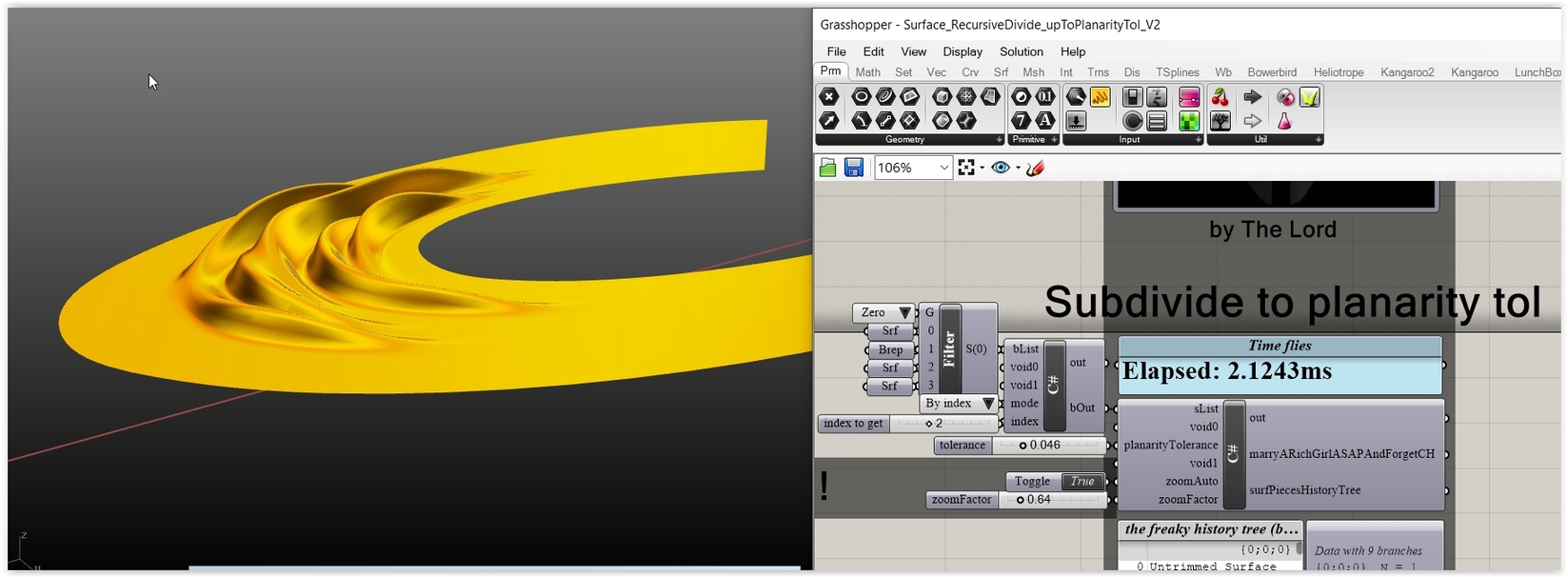

Okay we’re getting close! After a lot of research I was able to combine a grasshopper def with a c# to create the Gaussian curvature, recursive subdivisions and their principle directions all in one. I need to modify the c# so that the subdivisions change in size based on the Gaussian curvature being positive, negative or zero.
Osculating Circles_Vectors & Recursive Subdivision (C#).gh (11.6 KB)
Double Curve Test.3dm (282.0 KB)
Your issue Numero Uno is that you don’t use the V1A (the thing that deals with BrepFaces instead of Surfaces). This means that you are into a big rabbit hole with many entries but not a single exit (like tuning a Harley Davidson). Since these days the majority of facade panels are not Surfaces (unlike stuff the likes of Bilbao) … well … blah, blah, What if you receive a part that looks like a triangle BUT may be a trimmed thingy OR a Surface with a singularity OR a piece from outer space? What if you buy a V4R and set the engine mode to R? (and disable TC).
Other than that you’ll also need a filtering policy (like in V1A). Other than that you’ll need a proper recursion. Recursion is explained in depth in the Prophetic Trilogy:

BTW: With regard your recursion (up to tol). Imagine dividing a thing, picking a search policy (say min OscR in U or V as shown below), getting the points where Gaussian > tol (you can control that value obviously … but avoid getting lost in the translation) … and defining an Interval of interest (say the upper 30% as shown). Depending on the U/V values (the resolution, that is) we get either this:
Or that (or any other):
Notice that the percentage is the same (obviously) and the search Interval bounds are almost the same (in real-life are the same)… but you get a more refined result. Plus the u/v enumeration is grid like (meaning easier LINQ queries for the final part of the story)
Given all that the 1M question is: why bother with recursion?
And why bother with flat spots? (Gaussian < tol). But we should bother with the GC sign (meaning green TextDots for + , red for - … that does the VIB as well).
BTW: Your recursion is not correct: can you see from that pic why? Well … because you test for planarity 2 corners (so the blue and light blue ones stay intact) instead of doing the right thing for testing a quad planarity: min diagonal distance < planarityTol … or … wait … is better to use the R Method for that matter, case: bulges with planar corner pts etc etc (I’ll fix that by introducing the classic History Tree as well).
Prior the history (and some other freaky things) here’s your recursion (kinda a Pani V2: Less is waaaaaaaaaay more):
And here’s the correct results:

So whats actually changing is the size of squares based on the diag length sum but what about the color? Is that just to differentiate from the adjacent squares?

  1. A Quad Surface (during the recursion) is NOT a quad Mesh Face: this means that on first sight you may think that a diagonal min distance check is the thing to do … but think a bulge > meaning that the first is the good thing and the second the bad/naive thing:
  1. IF you base your stuff on the recursion (As I said, I can hardy see the point) you don’t need colors … because the smaller the pieces (or the more dense the u/v space mapping - see images with white dots below) … blah, blah.
  2. Imagine a resursive subdivision where the loops (L) are obviously topology related and thus unpredictable. Imagine a 3 dim tree where the 1st dim is the donor surf index (SI), the 2nd the state of L and the 3rd is either 0 meaning candidate pieces or 1 meaning planar ones. If you store each step we have a history Tree that starts from a branch (SI;0;0) … has L-2 branches (SI;state; 0), (SI;state;1) and ends in a branch (SI; L; 1) - meaning that all the pieces are declared planar. This is the proper way to do the job because it allows you to test each recursion loop on a per loop basis.
Results on some LOL test Surface (exploiting the last history branch):
Me? I prefer this way (seach via an Interval):
Than that way:
BTW: If you insist on Colors (but why?);
Surface_RecursiveDivide_upToPlanarityTol_ColorDemo_V1A.gh (483.1 KB)
