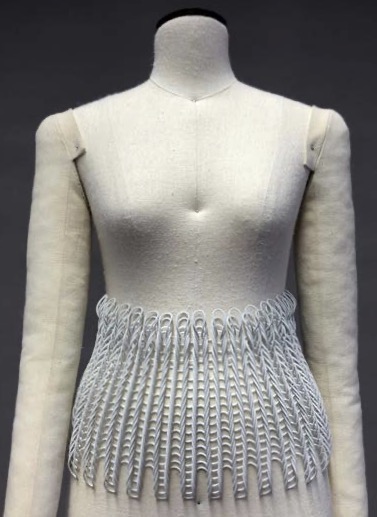

Digital knitting curves can create variable flexibility, even in rigid materials. The structure can be programmed with varying loops to adjust its performance.
Tube sample on half scale mannequin. Loop structure created a flexible, adjusting sleeve from rigid material.

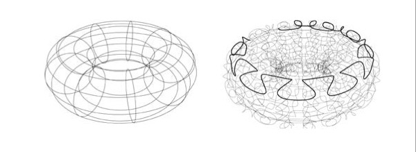

Using the uv grid of a 3d model to generate knitting curves along its surface. When these curves are piped a knitted structure is created which can be 3D printed.

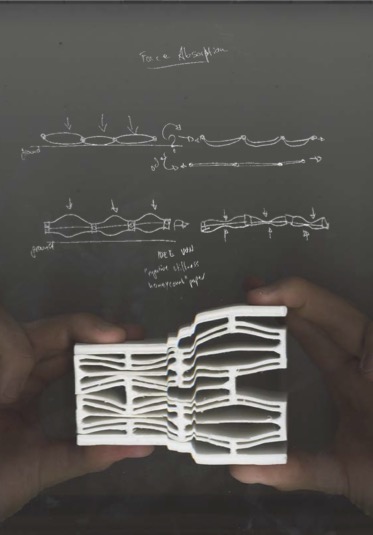

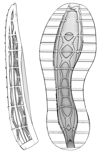

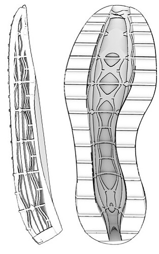

Shock absorbing honeycomb structure hidden in the sole.
gifff
A TPU FDM 3D print of the Negative Stiffneyy Honeycomb structure from this paper source: https://www.mdpi.com/2673-4591/76/1/51
The final object is a single material 3D printed shoe in SLS TPU that combines different programmable material strucutres: Varying knit structures provide the required support to the foot, and the negative stiffness honeycomb structure creates an elastic sole

This is super interesting! All in Grasshopper? Or is Knit 4.0 a plugin for Grasshopper?
thanks, yes its actually quite simple! It is just a quarter curve of a loop, arrayed to flow along the nurbs surfaces. so you can have as many u and v curves as you want, then run the loops along them. It’s quite an old project (2019/2020) but I might find the files for it somewhere
