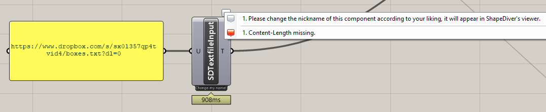

How would using dropbox work? That seems like it could be a very convenient method for me. I tried uploading your example txt file to dropbox and using the sharing link in grasshopper, but I get an error “Content-length missing”. What does that mean?

For dropbox, you need to give the “download” link, which ends with ?dl=1. If you use ?dl=0, it just gives a link to view the file on dropbox, which doesn’t work since we need to download it in the Grasshopper definition.
Perfect, it’s working now. Thanks for the help, Mathieu!
