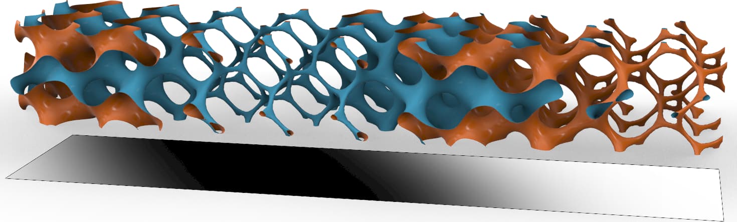

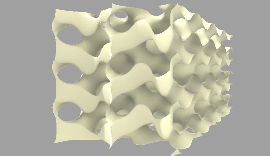

Isopod heat-exchanger and capped gyroids
Gyroid heat-exchanger seem to pop up more and more thanks to 3d printability. Isopod can be used to design one. The tricky bit is to keep the fluid-flows separate at the inlets and outlets.
Surfaces are defined by implicit functions as all points with a certain value (level), typically zero. TPMS (triply periodic minimal surfaces) produce values, which fluctuate between positive and negative (like a sine wave).
The custom TBO (Transition Boundary Object) component, takes a brep, an inner field (inside the brep) and and outer field as inputs, and generates a field as a combined output from these. If the inner field is a gyroid, and the outside field has a constant value everywhere, say “1.0” - then there are points with a zero value between the negative gyroid space inside the brep and the outside - this creates the capping surface. For positive gyroid spaces no such zero transition points exist - thus they are left open. The TBO takes an additional parameter to define the thickness of a transition zone to morph one field into the other more smoothly. The transition zone is inside the brep.
It is a good idea to normalize the TPMS functions, so that the the difference between the min and the max is 2 (typically this will result in a value domain of [-1, 1]). This makes the design process more predicable and easier to switch between different TPMS.
Here are examples for capping and a heat-exchanger. The domains for the different fluids in the heat-exchanger are separated by constant fields with value “1.0” for one fluid, and constant fields with value “-1.0” for the other fluid at the in- and outlets.
Capped TPMS.gh (33.7 KB)

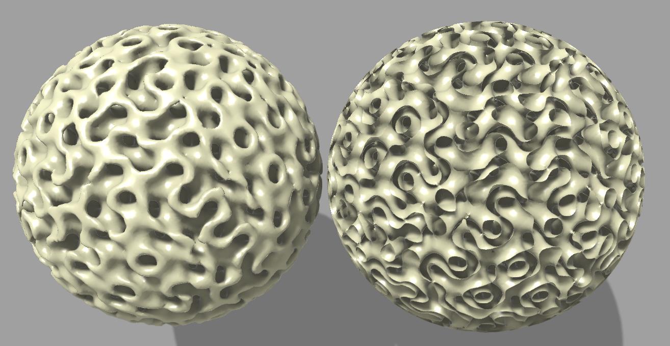

How did you do the falloff on this one?
Can you please show how to do concentric ripples with Isopod?
I’d like to have ripples just within a sphere or other closed volume and control over the blend between the ripples and the rest of the object.
The overlay of the original mesh with the displaced mesh shows that there is a tiny bit of displacment also on the part of the mesh which is not inside the red sphere. Ho can this be avoided?
button_fade_ripple.gh (7.9 MB)
Hi Martin.
You created some custom c# scripts to handle the wave function.
Imo it would be simpler to directly write your whole function + fall-off in a single c# script, instead of relying in a sequence of fields “math” operations.
Your ^8 exponent lead to almost zero field strength, but “almost zero” is indeed not “zero”.
If you create a custom field that output a simple “1 or 0” output depending of the sign of a field, you can simply use that to multiply your field and avoid the appearing waves outside the sphere.
