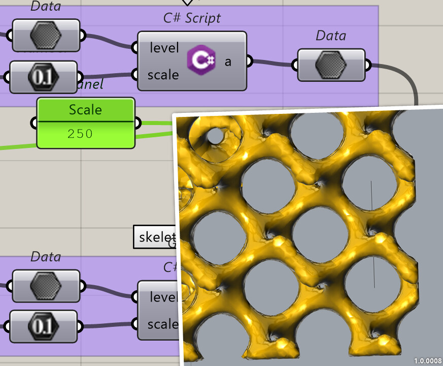

for the script I have many suggestions,
from my example you changed the scale of your object by a big factor and here size matters on many parameters.
  1. For the gyroid scale parameter is half the distance between 2 “holes’” !! You choose 1 for an object of a width of 10000 ! 250 seems more appropriate

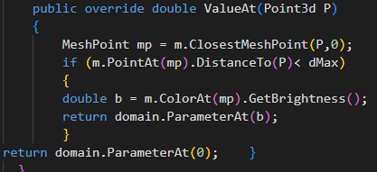

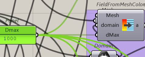

  2. Isopod has a disadvantage because component have not a lot of documentation BUT the very big advantage is that there are open and you can look how the work. Inside “FieldFromMeshColor” there is a closest point used so it means for a planar mesh that field will be the same along a normal. In order to limit the effect of field I added a max distance, if distance is more than dMax field value is the first of domain
  3. has size still matters , it seems better to take a box with an offset bigger, than 1 (1/10000) I choose 150, but this one I am not sure.
image_graded_gyroid2.5D_all-sidesLD.gh (1.6 MB)

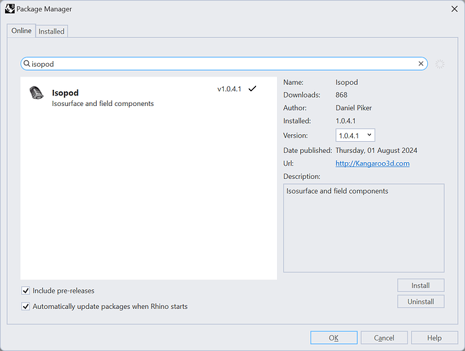

I just installed Isopod. Was able to sort out the path issue, but now I am stuck with an “Invalid cast: Goo >> iField” error message on the Isomesh component
Has anybody had a similar problem? Thanks for any suggestions !
Which path issue are you referring to? If the libraries are loading correctly, then it shouldn’t be necessary to do anything special to set the paths.
Did you uncheck the COFF option as shown here?

Awesome - thank you that did the trick! I had not been aware that GrasshopperDeveloperSettings is a commandline comand to be called in Rhino. After adding the correct paths and unchecking the COFF option everything seems to work.
