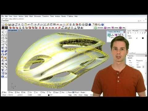

Is this kind of subdivision modeling possible in rhino. If yes tell how basic level user so explain in detail so that i give it a try
Yes, do some googling or searching on the forum into things like modeling bike helmets (similar topologies). I would probably use sub-D’s (or T-Splines if in R5) for that.
https://gilescody1.typepad.com/blog/2012/07/download-modeling-helmet-in-rhino.html

thechnically speaking, as of now, in the currenct Rhino V6 you do not have subDs.
but they are in the v7 WIP version. you could give these a try.
also to be more complete on this topic there used to be a plugin called T-splines for Rhino that was very well suited for this purpose, but adsk bought it and stopped porting it to Rhino V6 but it still exists for v5, but I am not sure if you can still buy it.
then there is Clayoo for Rhino, another plugin that has subD functionality. I have never used that myself, so I can not comment on it’s quality
