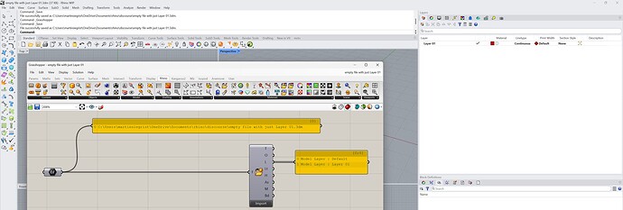

Import Content 'faking' layers
This is the layer structure of the V7 file, no more, no less.
Same file imported with Import Content (WiP) has two more layers:
Can you explain what is happening here?
PS. No blocks
A hint for where to search:
By Parent was created by VisualARQ, without my ‘consent’ :enraged_face:
Default was created when copying object from WiP file (from B dimensions layer) :enraged_face:
File was purged before quitting session.
One additional layer, in my case ‘Default’ is not present in the linked file.
No blocks either.

Hi Cumberland
Read the whole topic again.
It is about adding layers that do not exist in the original file: Default and By Parent (confirmed by Martin).
Below is an example with a fresh empty file where I deleted everything but Layer 01.
empty file with just Layer 01.gh (10.0 KB)
empty file with just Layer 01.3dm (33.2 KB)

The component worked like this always.
It is doing an Import operation.
An Import operation in Rhino just import these things are referenced from the model space.
This is why Default layer appears magically and not referenced Blocks are missing.
I see how this is not the expected behavior.
Let’s see what we can do on the next RC.
