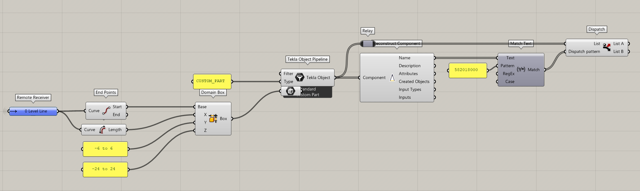

In my current workflow, I’m using the component like this:
But what I imagine is something like this, where I just get all CustomParts in a bounding box:
Usually, I expect only a few parts in the bounding box, so even just having a type filter like CustomPart would be more than enough. That way I could skip the full model query and handle any further filtering (like name or attributes) in later steps.

Hi, here’s an update with an added Box input. Give it a go and see what kind of results you get:
[EDIT: Latest installers on Tekla Warehouse ]
Ok that’s great, checking the object type like CUSTOM_PART isn’t costing much. It’s just applying a filter that can become slow if there are lots of objects in the bounding box. If there’s only a handful of objects within the bounding box it should be at least an order of magnitude faster for decent sized models.

That’s exactly what I needed—just ran a first test and it works amazingly well. Huge thanks for this!
