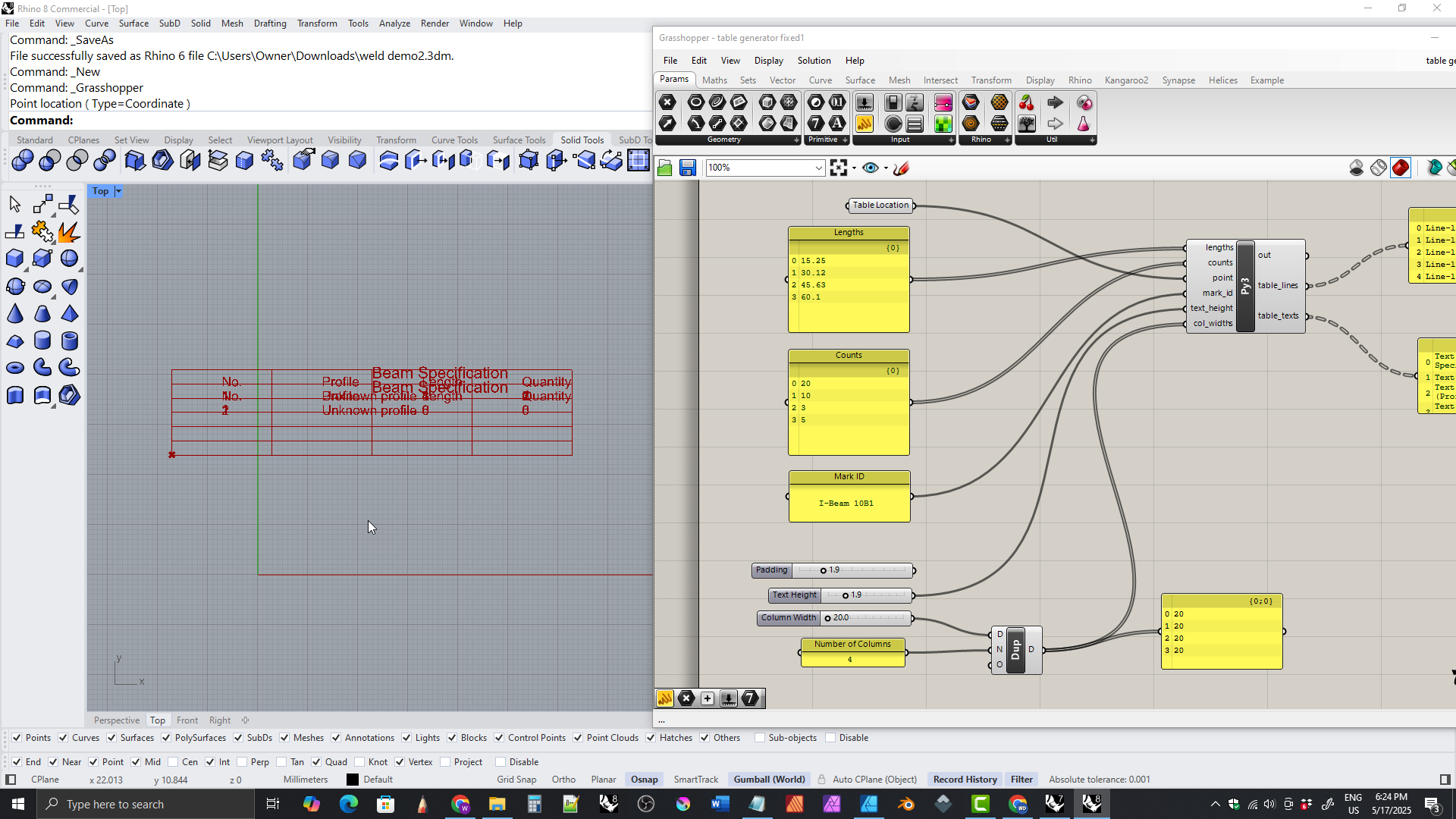

I got it working somewhat. It makes the table but the text is a jumbled mess.
In line 128, pt should be point to match how you named the point input on the component.
table_lines, table_texts = draw_beam_table(pt, marks, lengths, counts, text_height, col_widths)

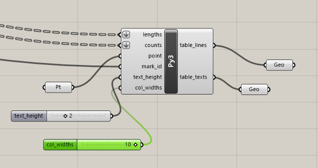

In line 31, col_widths needs to be a list of floats with list access, you provided a single float. I corrected this by running the col_widths slider value through a DuplicateData node. I also right-clicked on the variable slot on the component and changed it from item access to list access.

Also, you may have done this, but just in case you didn’t, the location point slot needs to be given a type hint of Point3d or else you can’t get the X, Y, and Z components from the base_pt varialbe like in line 38.

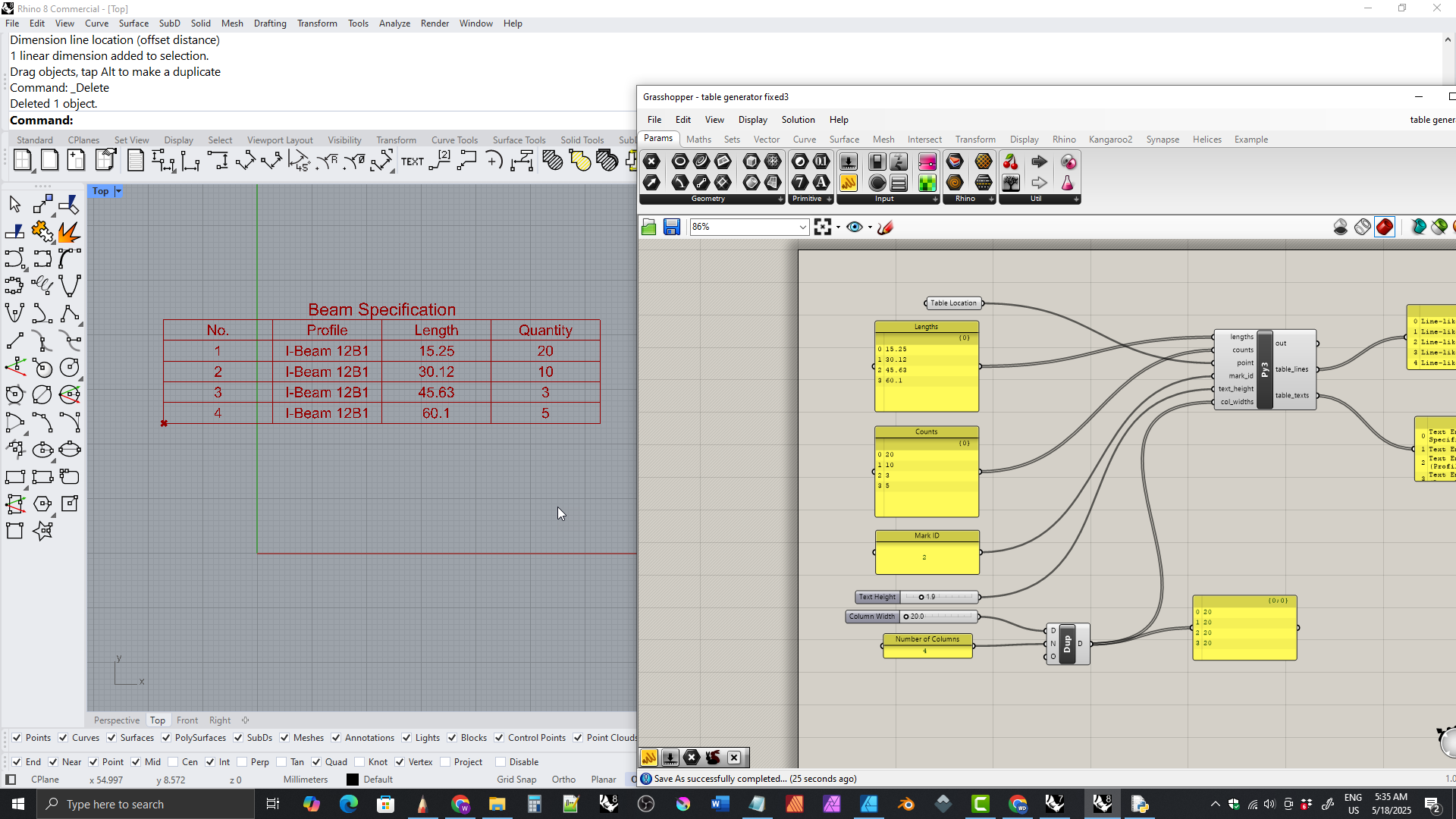

Ok, I got your code working. I just needed to give list access to the other lists and set the type hints on everything. This made all the text appear, but it was not quite lined up with the grid. To fix that I changed the justification on the text in the cells to MiddleCenter and the justification on the title to BottomCenter.
Oh, and I changed the row_height variable to 2 times the text height rather than 1.5 because I thought it looked nicer.
row_h = text_height * 2.0
table generator fixed3.gh (14.1 KB)
