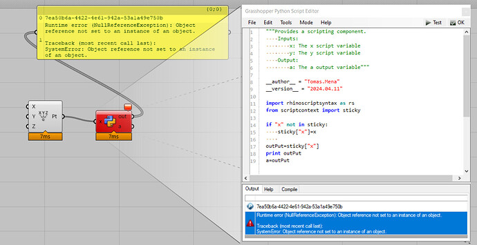

Hi all
I’m trying to store geometry values (something coming out of a geometry component) in the sticky dictionary to retrive it using other ghpython component but when assigning the output variable the sticky value I get an error.
Does sitcky supports other types beside strings, integers or floats?
from scriptcontext import sticky
if "x" not in sticky:
    sticky["x"]=x
outPut=sticky["x"]
print outPut
a=outPut
Runtime error (NullReferenceException): Object reference not set to an instance of an object.
Traceback (most recent call last):
SystemError: Object reference not set to an instance of an object.
sticky is a normal Python dictionary, so you can shove anything you like in there:
240411_StickyGeometry_00.gh (9.3 KB)
