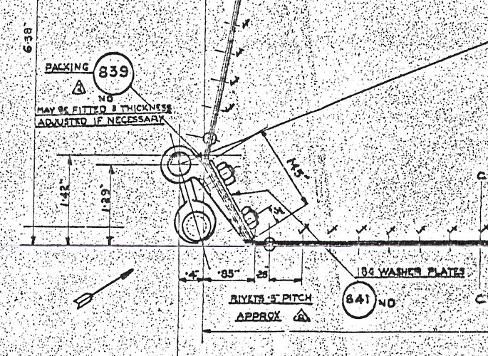

We, including the worlds BEST CAD aircraft plan creator, work to WW2 drawings marked in feet and inches, we recreate WW2 items and feet inches is vital.
Trying to add into a WW2 drawing items dimensioned in mm , when they were built to decimaL is asking for trouble.

I find it odd that a WWII drawing would be specified in decimal inches. That seems to undermine the accuracy of the fractional representation? In fact, I thought it would be the sort of practice that would have seen various stationary thrown at the producer of such a drawing; as he is told to take his mustache and smoking jacket far away from the Marble Hall.

All Supermarine Spit drgs were decimal inches for constructional distances and parts to be made.
Hawker shows Imperial for pre existing purchasable wires and tubes. decimal for constructional distances.
I would hazard a guess that Avro, Shorts, Westlands, Bristol, Frazer Nash, Boulton Paul etc etc also followed same practice.

Steve, I’ve only seen Supermarine’s wartime blueprints for a few small parts and they have all been in decimal inches. Have you seen any original blueprints for large items like wings or fuselage? All the Internet stuff seems like modern recreations. If you have, what units did they use?

Blueprints created by British Industry at the time will have been governed by British Standard 308, Engineering Drawing Practice. Now I only have a copy from 1953 which I cannot say with absolute certainty would give the same instruction as the wartime edition - but I would be surprised in this case if it didn’t.
Clause 13 a. (v) states:
Where feet are used as one unit of a dimension, it is preferable to express parts of an inch in fractions, thus: 5’-7½" and not 5’-7.5"
And Clause 13 a. (vi) states:
Where decimals are used, any figures preceding the decimal point should preferably be given in inches and not in feet and inches, thus: 25.42" and not 2’-1.42"
Thus to dimension in feet and decimal inches would seem to be in contravention of the British Standard, unless you can show that the wartime standard was materially different.
Rhino supports the two schemes approved by the standard. It does not seem unreasonable that it doesn’t include a scheme that contravenes it.
