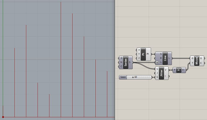

Jitter.
sort_lines_2020Nov1a.gh (6.6 KB)
I created a different model because sorting (or jittering) lines that are all the same length is not visually interesting.

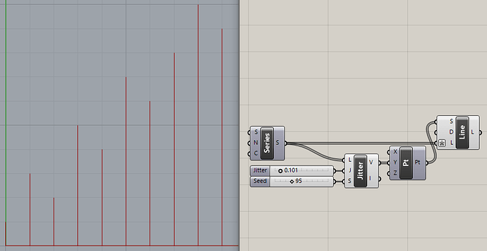

sort_lines_2020Nov1b.gh (5.7 KB)

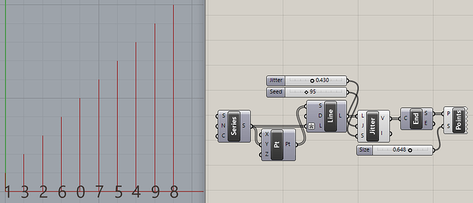

Even when the lines are not the same length, the jitter/sort is not visually evident because their positions don’t change, only their sequence in the list as indicated by numbering their start points.
sort_lines_2020Nov1c.gh (7.3 KB)
