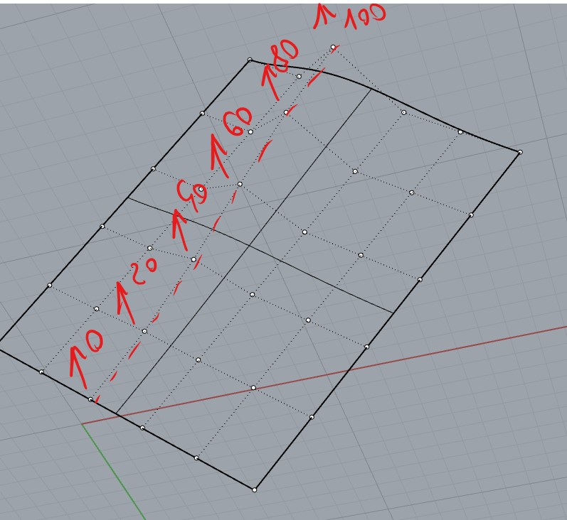

I would like to move control points on the surface and on curve proportionally (mainly in Normal direction).
I know about SoftMove command but it works only with radial falloff not with linear one and I can`t see option for moving according to Normal direction. This flat plane is an only a simple example of my question.

Yes, I have Rhino 7 WIP. Thanks but I`ve thought rather about something like that (for control points of curves and surfaces - not for subd):
curve_faloff
falloff_tool

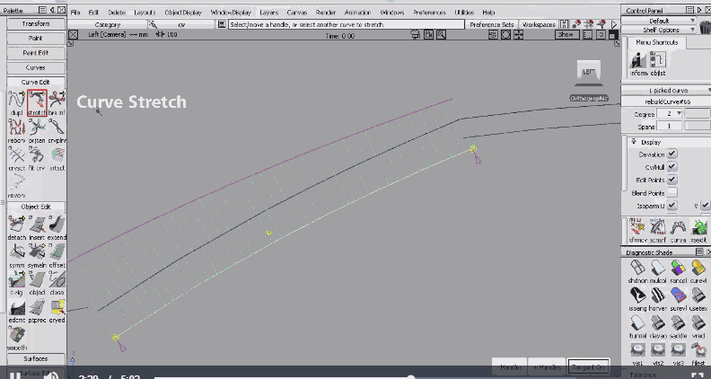

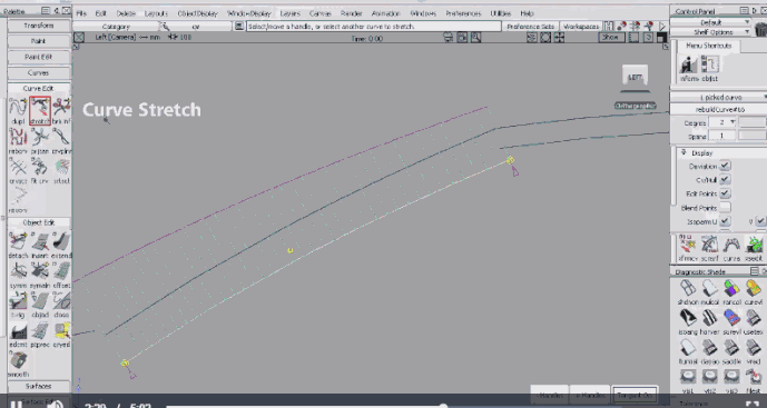

Edit: In Alias there is something like Curve Stretch. Has Rhino something similar? This is not same but also will help me a bit

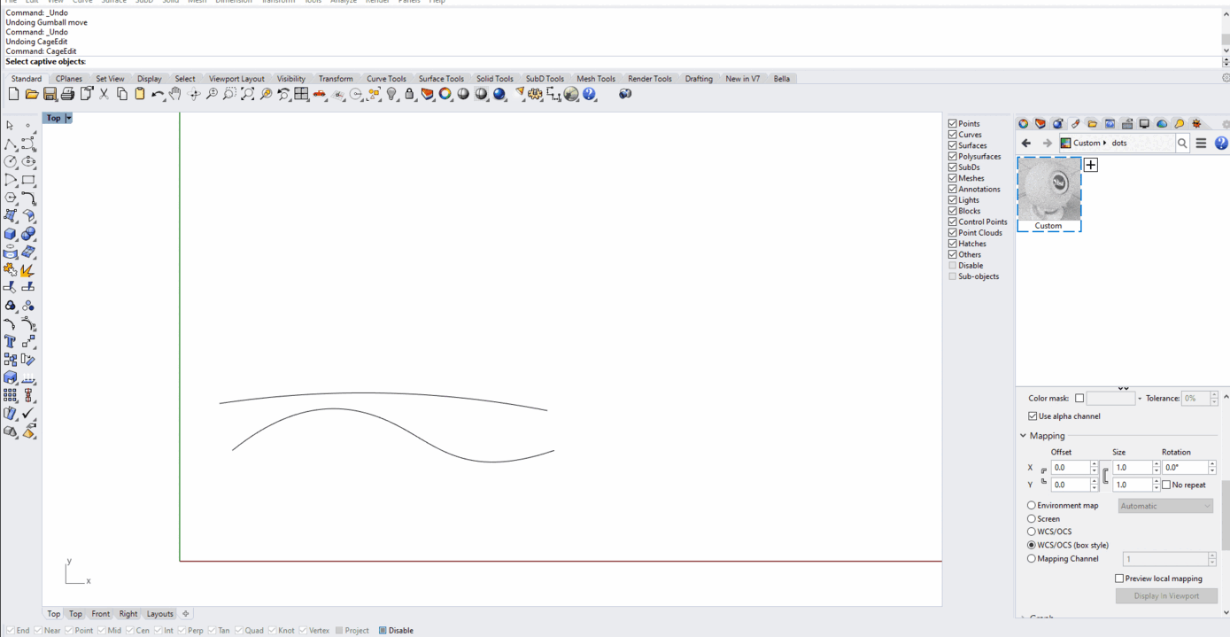

cage edit using a curve as a control object may get you there-
this is a little known superpower of cage edit-

make an alias for cage edit with a pause for picking the control curve and you’d have a 1ish click solution-

It works well over surfaces. Is it possible to do it without changing control points? Changing shape adding a lot of new control points. I would like to keep the current count of control points. Is this possible?
Hello - when you set up the control, make sure to set 'PreserveStructure=Yes"
