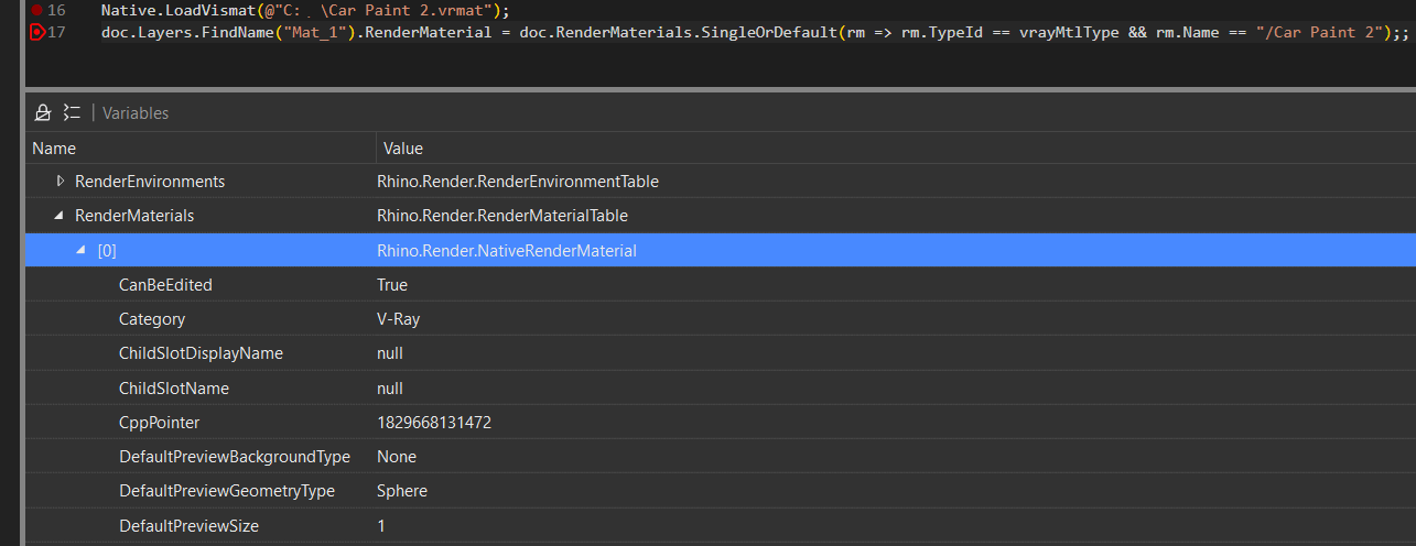

Thank you for your answer, but for some reason the materials only appear in the RenderMaterials list after the command is called again (after rendering).
How can I refresh or update the material list before rendering?
doc.Views.Redraw(); doesn’t help.
If LoadVismat() does not make the object appear in the material panel, then there is something wrong with your file, or with the document - f.e. locks. This will most likely not work, if you run it while another command is executing.
I tested this script on an empty file, and it worked out of the box.
Once the script is run, check the if the material shows up in the Asset Editor.
You may need to debug your specific setup.
doc.Views.Redraw() only redraws the viewport, that has nothing to do with refreshing panels.
This material shows up in the Asset Editor, but when the script is running, the RenderMaterials are empty and I cannot call doc.RenderMaterials.SingleOrDefault(rm => rm.TypeId == vrayMtlType && rm.Name == "/Wood");
The material only appears after the script is executed.

Well, it certainly works from the play button:
It is executed on the main thread and the RenderMaterial collection is definitely updated. Both on the C++ and .NET side.
It is probably something related to the command class in particular
My command is executed in the main thread, and I checked this through the bool insideMainThread = RhinoApp.InvokeRequired;
