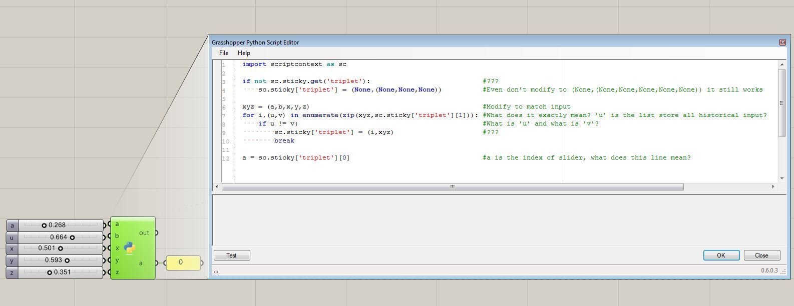

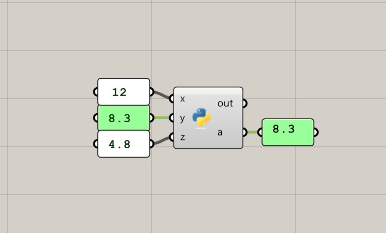

If there are multi-inputs, is it possible to let GhPython to detect and choose the latest inputted value?
Say I have 3 inputs are 12, 8.3 and 4.8, and the last one I type in is the 8.3, I want to let GhPython automatically always choose the last number I type.
Splendor!!
I have tested it and it works perfectly!!

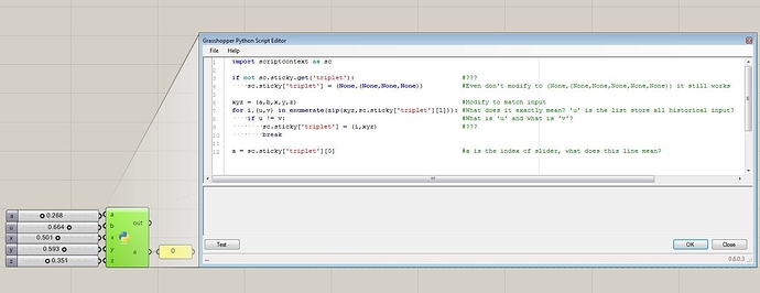

Could you explain a little bit more what is sticky and what it exactly doing?
Just want to learn a bit more on this…
I am not too good when it comes to explaining… But you can google sth. like “sticky python grasshopper”. It’s been answered several times. Sticky generally is a dictionary in which you can save all kinds of things to save state. And triplet is a tuple.
