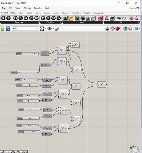

Hello!
Im new to the software, can someone please guide me how to merge or join lines
Regards
Type “Join” in the search box, then connect all lines to the C input.
// Rolf
Or, in the example you are showing, feed the points into a polyline.
(you can make multiple connections by holding shift when you connect them)
