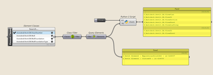

Hi all,
Is it possible to get the “print set” by RIR.
pls see the screenshot below.
Thanks.
There is no native component but can be done via API.
Hi @JinLong,
I hope this is what you are looking for
Printset Definition.gh (8.5 KB)
Hi @Muhammad_Saqlain_Awa
Thank you for the reply, that is good for me.
I also want to know,If In Revit, the print set has already been set up. How can I get the sheets included in this print set in RIR?
Thanks
@JinLong Yes you can
 import clr
clr.AddReference("RevitAPI")
clr.AddReference("RevitAPIUI")
clr.AddReference("RhinoInside.Revit")
from Autodesk.Revit import DB
from RhinoInside.Revit import Revit
doc = Revit.ActiveDBDocument
sheets = []
if GO and PS:
    try:
        if isinstance(PS, DB.ViewSheetSet):
            sheets = list(PS.Views)
    except:
        pass
It works great!
Thank you very much for your answer
