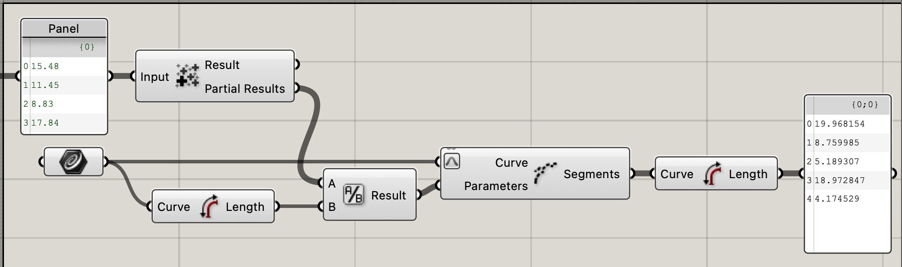

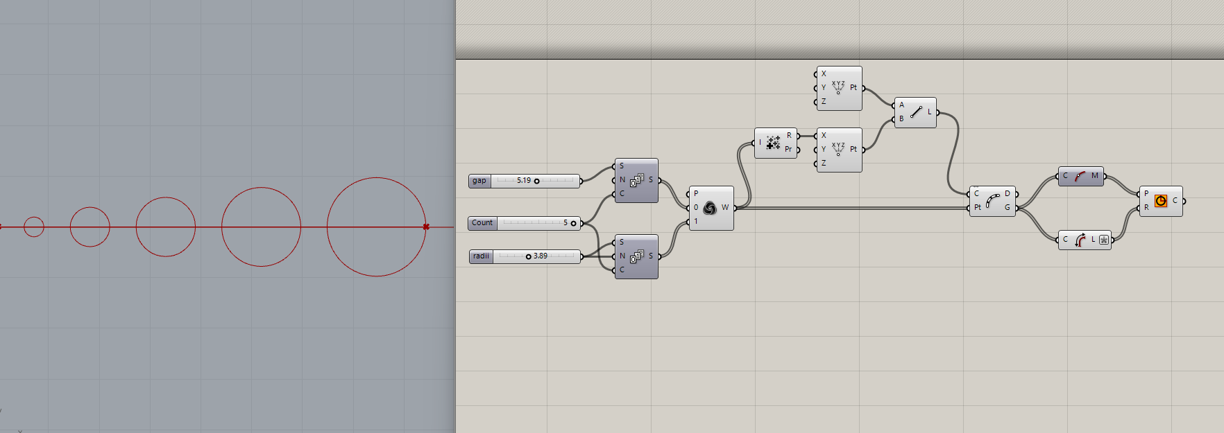

How to divide the curve by the varying distance?
I’ve only glanced through this thread but noticed some images resemble these from a recent thread.

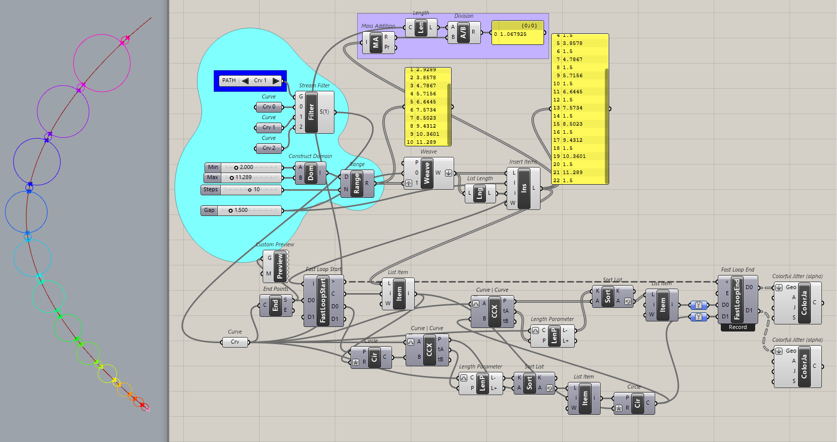

The list in the largest text panel (on the right) determines segment lengths for the Anemone loop below.
P.S.
crv_circles_2023Nov17a.gh (19.0 KB)
I liked the Dash Pattern method suggested by @Seghier_Khaled better though.

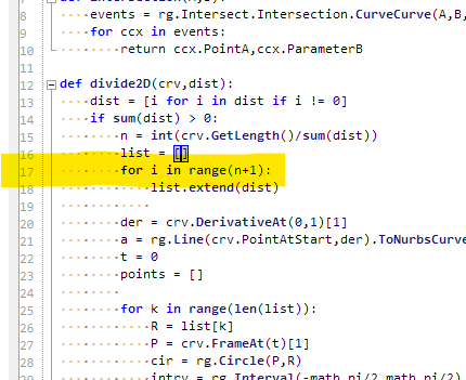

Hi
At the line 17 replace n by n+1
curve multi_distances.gh (7.0 KB)
Hi Magicteddy, thanks for the component
when I’m trying to put this code in C# component I get an errors can you please tell me what I did wrong
  1. Error (CS0115): ‘Script_Instance.SolveInstance(Grasshopper.Kernel.IGH_DataAccess)’: no suitable method found to override (line 61)
    I just copied and pasted your code
