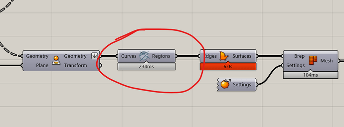

So far, I’ve tried using the “Geometric Cell (Create Regions from a List of Curves)” component from Heteroptera, and it works only when the input lines are clearly distinct.
However, when edges are very close but not identical, the component struggles or fails to generate proper regions.
:red_question_mark:My main question:
How can I robustly compute planar regions (closed curves) from a set of intersecting polylines — especially when many are nearly overlapping?

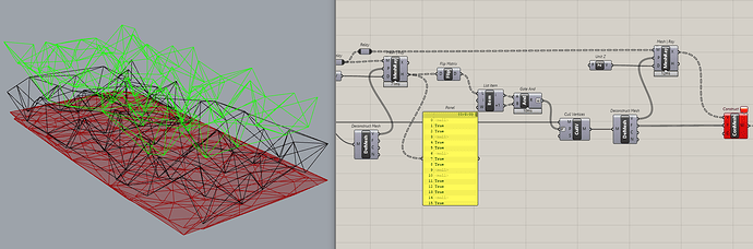

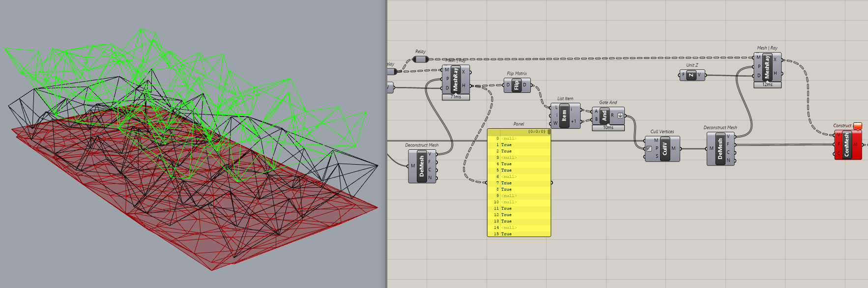

the attached script doesn’t work in my R8 Rhino because of the many Nulls that are generated in the Hit/Miss output of MeshRay:
[edit]@wim in R8 SR22 (8.22.25196.13001, 2025-07-15) MeshRay component outputs Nulls instead of Falses: the hit/miss output lists only True or Nulls, no Falses
but if I Replace hit/miss Nulls with Falses it produces a result:
landscape ex_Replace_Nulls.gh (18.5 KB)

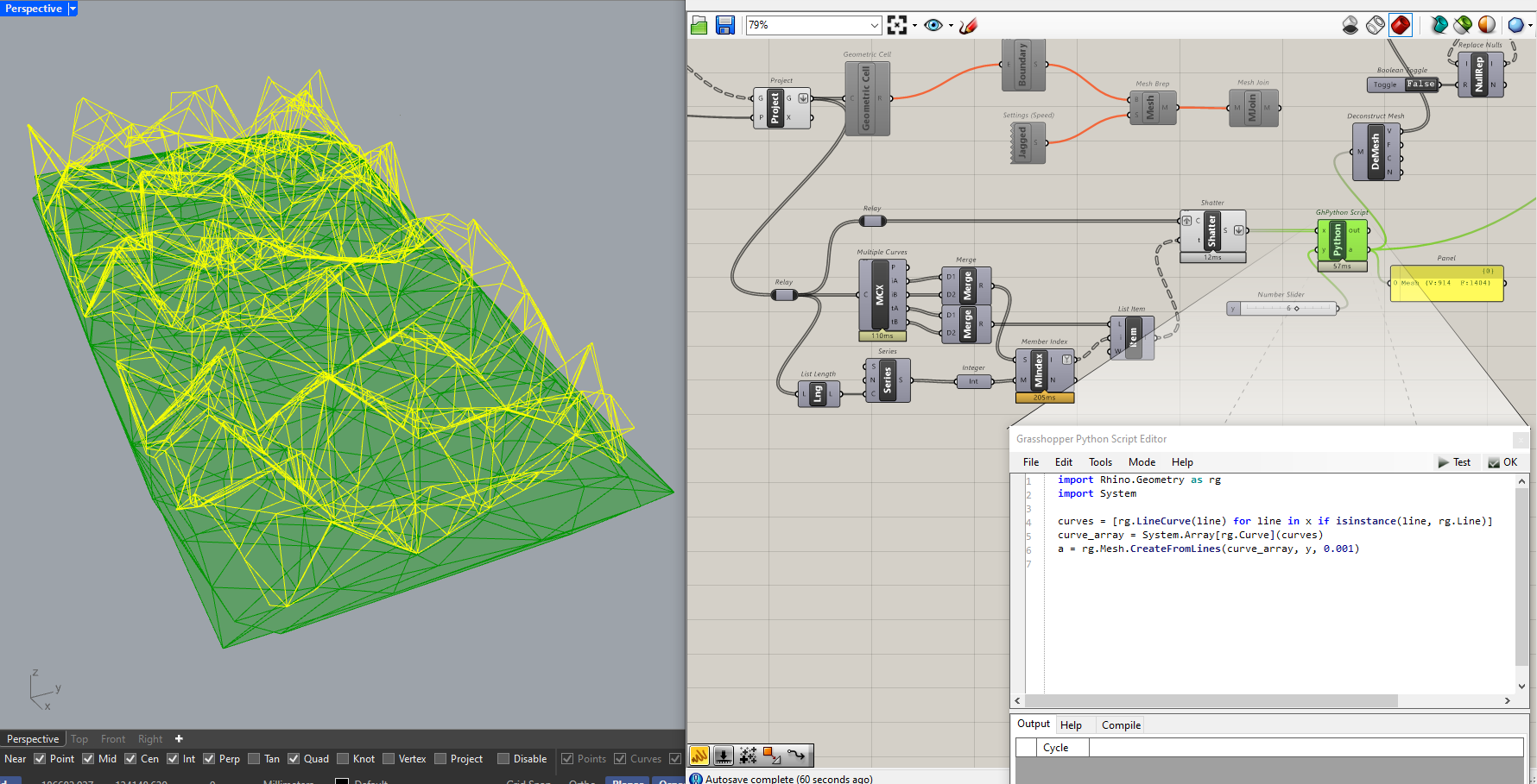

[edit] instead of using Heteroptera’s Geometric Region + Boundary Surface (which I guess becomes progressively slower the more dense your Meshes are) you could shatter the projected Mesh Edges into smaller Line fragments using Multiple Curve Intersections, then triangulate those fragments directly? something like this, with noobish use of Mesh.CreateFromLines (but note that you need to increase the Face Valence -in the example to 6: Y variable- to have it working…)
landscape ex_inno.gh (22.5 KB)

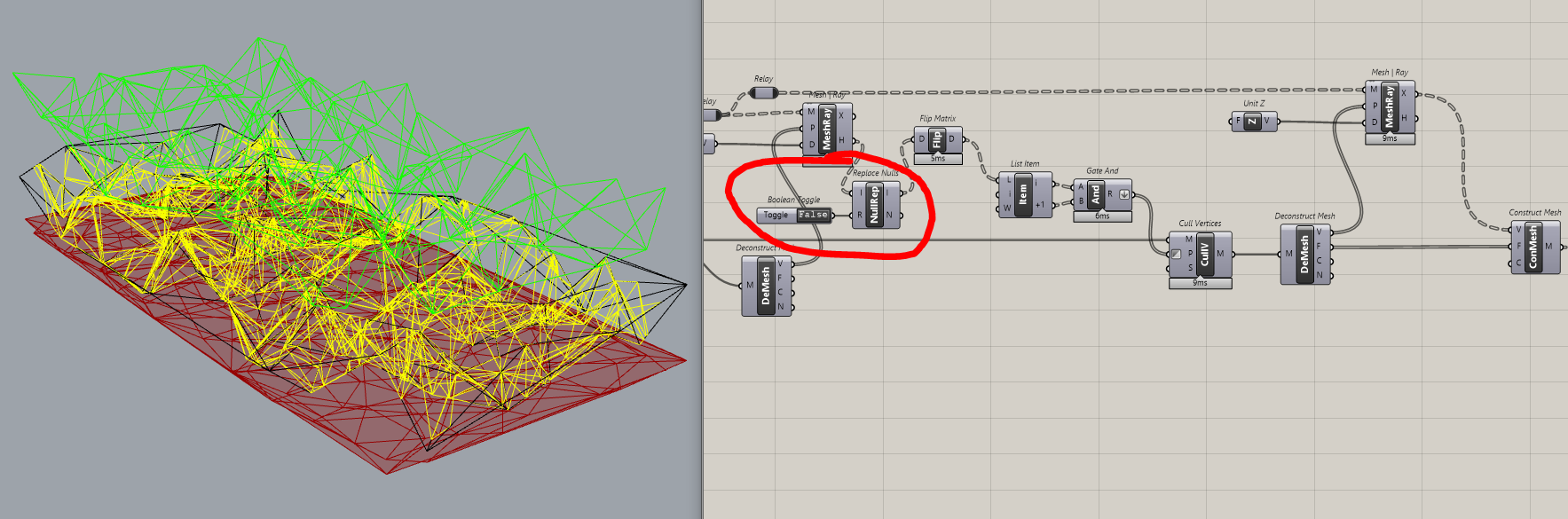

landscape_topoIDENT_jvs.gh (25.7 KB)
not sure if that works with rhino7 but think it should.
…playing with different seeds i found a mistake.
sorry.
improved a bit:
landscape_topoIDENT_jvs_02.gh (27.2 KB)
