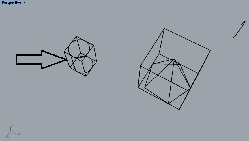

Hi All
CRhinoCommand::result CCommandTest::RunCommand(const CRhinoCommandContext& context)
CRhinoGetObject GetObj;
GetObj.EnablePreSelect(FALSE);
GetObj.SetCommandPrompt(L"Select objects to frame with a box");
GetObj.SetGeometryFilter(
CRhinoGetObject::surface_object |
CRhinoGetObject::polysrf_object |
CRhinoGetObject::mesh_object
GetObj.SetGeometryAttributeFilter(
CRhinoGetObject::closed_surface |
CRhinoGetObject::closed_polysrf |
CRhinoGetObject::closed_mesh
GetObj.EnableSubObjectSelect(false);
GetObj.EnableGroupSelect(true);
GetObj.GetObjects(1, 0);
if (GetObj.CommandResult() != CRhinoCommand::success)
return GetObj.CommandResult();
int i, count = GetObj.ObjectCount();
for (i = 0; i < count; i++)
if (GetObj.Object(i).Object())
ON_BoundingBox bbox;
GetObj.Object(i).Geometry()->GetTightBoundingBox(bbox, bbox.IsValid());
ON_3dPointArray boxcorners;
boxcorners.Append(ON_3dPoint(bbox.Corner(0, 0, 0)));
boxcorners.Append(ON_3dPoint(bbox.Corner(1, 0, 0)));
boxcorners.Append(ON_3dPoint(bbox.Corner(1, 1, 0)));
boxcorners.Append(ON_3dPoint(bbox.Corner(0, 1, 0)));
boxcorners.Append(ON_3dPoint(bbox.Corner(0, 0, 1)));
boxcorners.Append(ON_3dPoint(bbox.Corner(1, 0, 1)));
boxcorners.Append(ON_3dPoint(bbox.Corner(1, 1, 1)));
boxcorners.Append(ON_3dPoint(bbox.Corner(0, 1, 1)));
ON_Brep* pBrep = ON_BrepBox(boxcorners);
if (pBrep)
CRhinoBrepObject* BrepObject = new CRhinoBrepObject();
BrepObject->SetBrep(pBrep);
if (context.m_doc.AddObject(BrepObject))
context.m_doc.Redraw();
else
delete BrepObject;
return CRhinoCommand::success;
why is there more of a boundingbox when I remove the “SetGeometryFilter” condition ?
