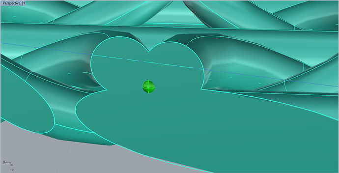

now i got something problem with center part space to trim…
i use cutting plane then join… got naked edge (point)
how to solve it … :slight_smile: big thanks guys :slight_smile:
remain 1 naked edge and 1 nonmanifold
the red surface is the problem
with the naked edge point can be solve with absolute tolerance change from 0.0001 set to 0.001 ?

For the naked point try my newest favorite command - testremoveallnakedmicroloops
It’s solved a lot of problems for me this week!
Hi Cliffonde - the opening is not planar there - quite, you should fix that. Also, I am not sure what you want to do with the point that is poking just in the middle of that area - what will be hard to close off if it just touches the plane when you get it cleaned up.
TestRemoveAllNakedMicroLoops doesn’t fix this, it isn’t a micro loop as I understand it.
@pascal, the surface was wirecut with a curve, not a line, it comes close to planar, but I don’t see why it needs “fixing”. You would go crazy trying to make all the splits planar and lose the smoothly curved outline of the chainmail.
Okay, @imu2009, this might not count as “clean” modeling, but here is a real-world quick fix for stuff like this that is too small to really count but prevents you from getting a watertight object so you can move forward. Make a small sphere centered on the naked edge point and booleanUnion it in. This will fill in the backside where the surfaces intersect a little, but not enough to show for most purposes (I’m guessing you are making jewelry and will be printing this object). Now Untrim the front part of the sphere out of the flatish surface, and it will look perfect from the side that shows.
