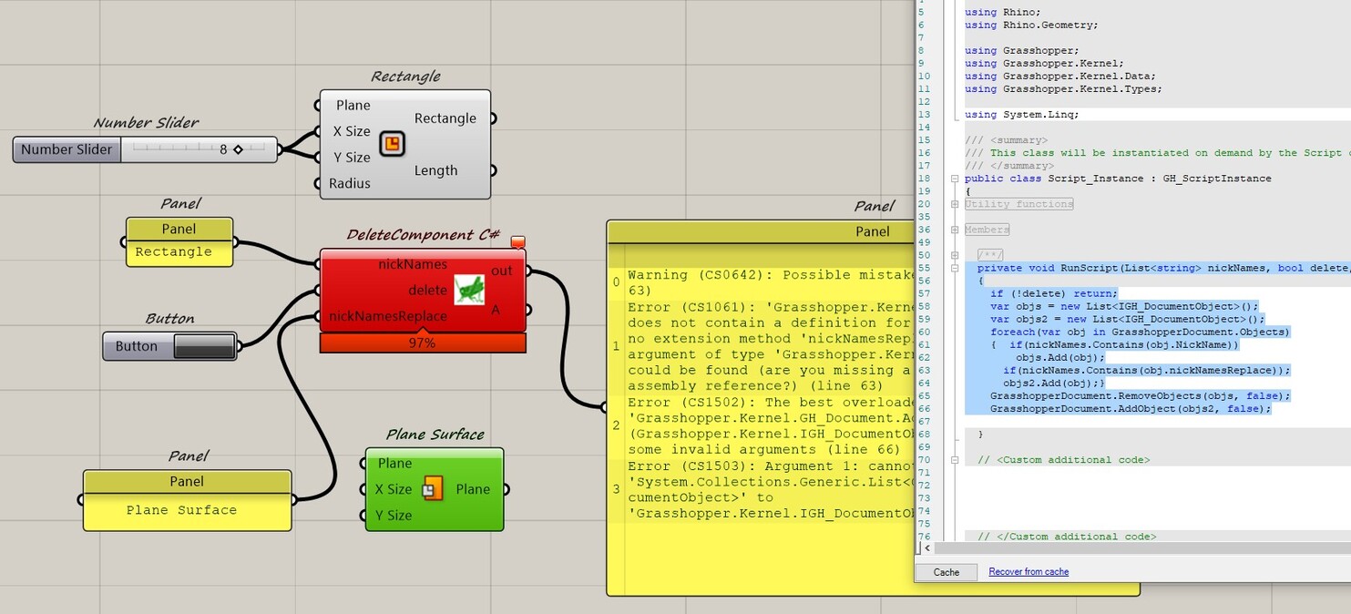

Just one more question about this post, maybe we can replace all the x components in the same position with the y component? For example, wherever the tool was called panel, replace it with valueList or numbers slder …?all panel replace by numberslider
@Mahdiyar
  private void RunScript(List<string> nickNames, bool delete, object nickNamesReplace, ref object A)
    if (!delete) return;
    var objs = new List<IGH_DocumentObject>();
    var objs2 = new List<IGH_DocumentObject>();
    foreach(var obj in GrasshopperDocument.Objects)
    {  if(nickNames.Contains(obj.NickName))
        objs.Add(obj);
      if(nickNames.Contains(obj.nickNamesReplace));
      objs2.Add(obj);}
    GrasshopperDocument.RemoveObjects(objs, false);
    GrasshopperDocument.AddObject(objs2, false);
replace.gh (20.5 KB)
Please actually read the error messages and try to understand them instead of trying to guess your way through typing code.
  1. nickNameReplace - you came up with this name. It does not exist in the Grasshopper API on IGH_DocumentObject. You can’t come up with names and expect them to work. You want to check whether obj.NickName is equal to nickNameReplace.
  2. Your code layout is horrible. Take time to write it properly: good indentation, good bracketing, etc.
  3. For error 3 in your screenshot: read the documentation on AddObject and now try to understand why the error happens. Then think about how to fix it (hint: foreach)
